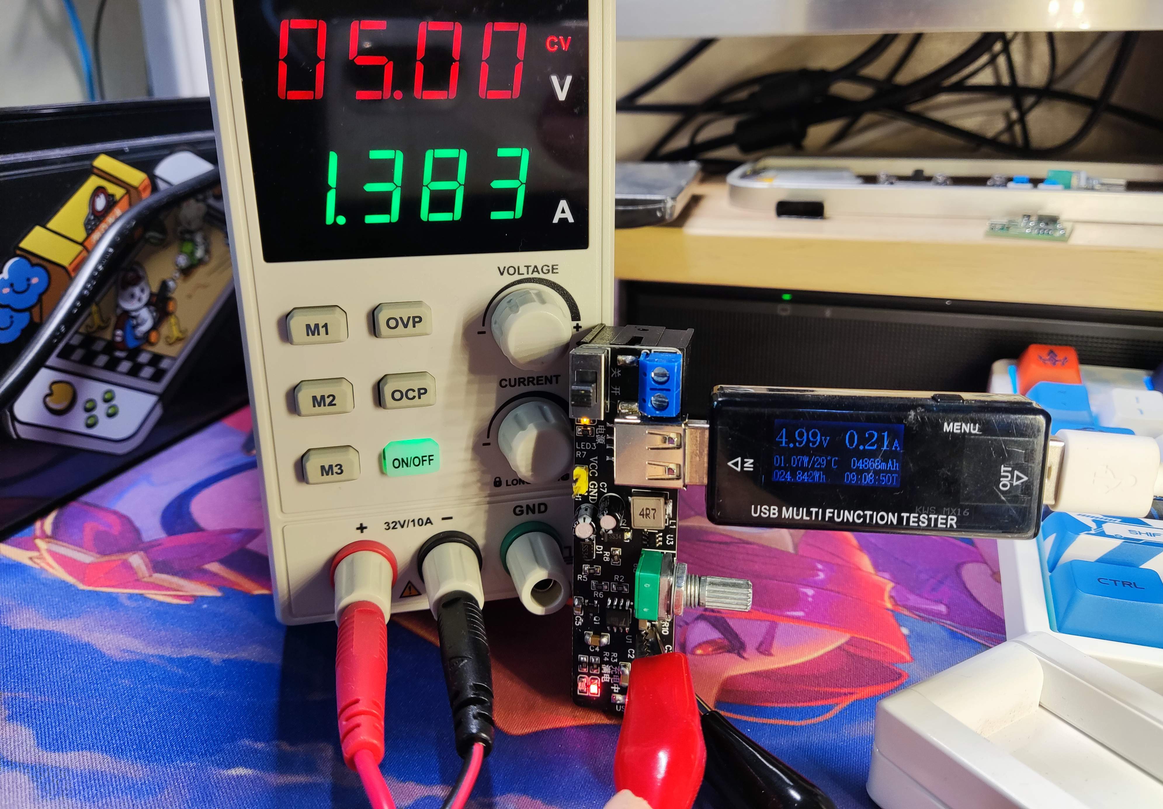

As shown in the picture above, when there is 5V, the input is only 1.4A. The battery is charged at 1A, but I don’t know how much the charging chip consumes. The specification does not say. If we set 1A for the time being, then the actual boost consumption is only 400mA. Loss is not considered. Therefore, it can only carry a small load in plug-in mode.
However, the load that can be carried in battery mode is much larger than when plugged in 5V, which is the amount written in the boost chip manual.
