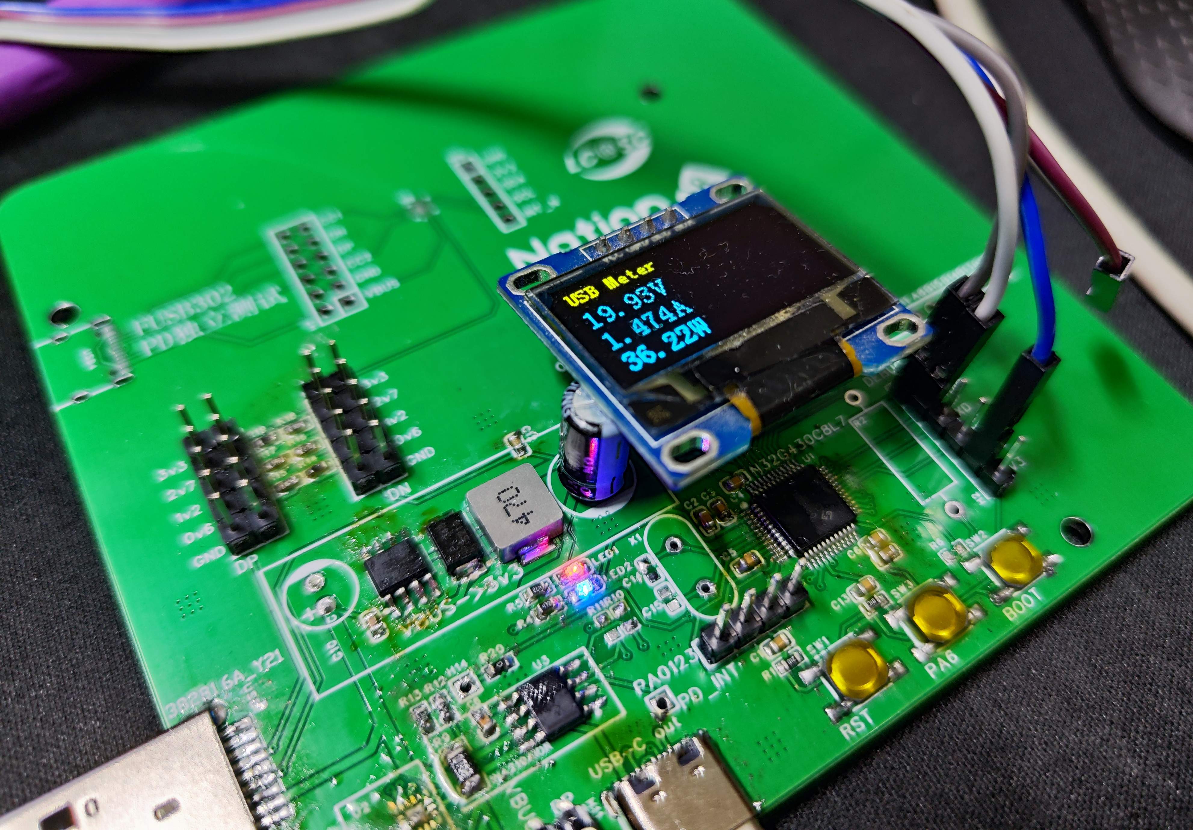

1. Introduction to project functions
After paying attention to the charging head network, I found that they used a series of Power-Z products to evaluate charging equipment. It happened that the case of this training camp was a USB ammeter, so I had the idea of ​​imitating a charging protocol detector.
Protocol detection
Currently, most community solutions for fast charging are power supply equipment, such as power banks and desktop power supplies. There are not many types of powered equipment and they support a single protocol. Therefore, if you want to implement fast charging protocol detection, you cannot rely on only one protocol chip, and some protocols need to be implemented by software. The full protocol requires the use of USB-C's DP, DM, and CC pins for handshake communication, so the 6P USB-C interface cannot be used, and a USB-C 16P interface is required.

The current goal is to achieve QC/PD dual protocol detection. The current two protocol standards are up to QC4 and PD3.1.
The PD protocol is divided into "fixed gear" and "programmable gear". The negotiation handshake is more complicated and is implemented using a USB-PD control chip. The difference between USB-C and USB-A is that USB-A outputs 5V by default, while USB-C outputs 0V without device recognition. Therefore, USB-C needs to provide a trigger signal to make it have voltage output when connected.

An independent USB-C port is set up for the hardware part, and a multi-level voltage source is provided next to it. It is not connected to the main device and is used to test voltage triggers such as QC under DP and DN configurations.
The PD protocol trigger uses the FUSB302B chip, which has two packages, WLCSP9 and WQFN14. The WLCSP9 package can be replaced with the RT1715WSC (C2976586) Pin-to-Pin.
FUSB302B supports up to PD2.0 protocol, while RT1715WSC can handshake PD3.0 protocol (without Fast Role Swap (FRS)). The functional
protocol chip address is 0x44, 0x45. The current progress can read the chip model, version number, and step.
The voltage and current detection is completed by the INA219 chip, which communicates with the MCU through I2C. In the circuit design, INA219 configures the I2C address to 0x40, the write address to 0x80, and the read address to 0x81.
Initialize the configuration register address 0x00, initialize and configure in the main function; the project uses BUS voltage reading and sampling voltage reading, and the USB voltage and current are obtained after calculation.
