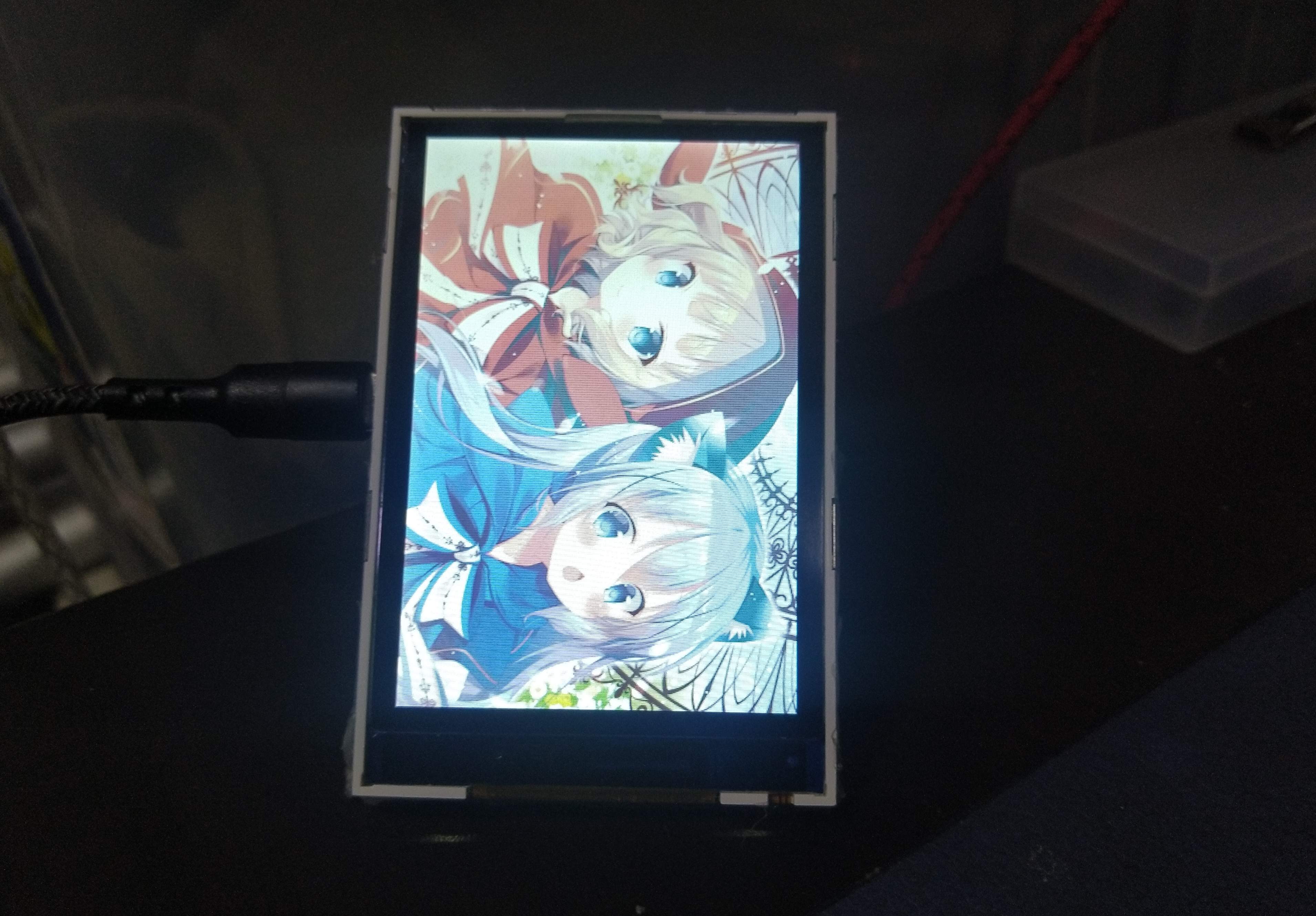

·Desktop information board based on ESP32S2
·Screen: Laowang 3.9 yuan 3.2' TFT (TA7601)
·Screen resolution: 320*480
·Refresh time: ~400ms (pure gpio operation, rewrite the bottom layer by myself, it will be faster when using i2s in the future)
·Power consumption: 1.5W (MAX)
ps: The display effect of this screen is very good. Unfortunately, I bought less and many pieces were broken during shipping. I only have about ten pieces left on hand.
You need to use about two glue sticks to stabilize the center of gravity of the board
·Planned to be used as server/PC hardware status display panel
·The host computer is basically complete except for communication, and is compatible with mainstream versions of Windows/Linux
·The lower computer is currently stuck on the gui library written by myself.
