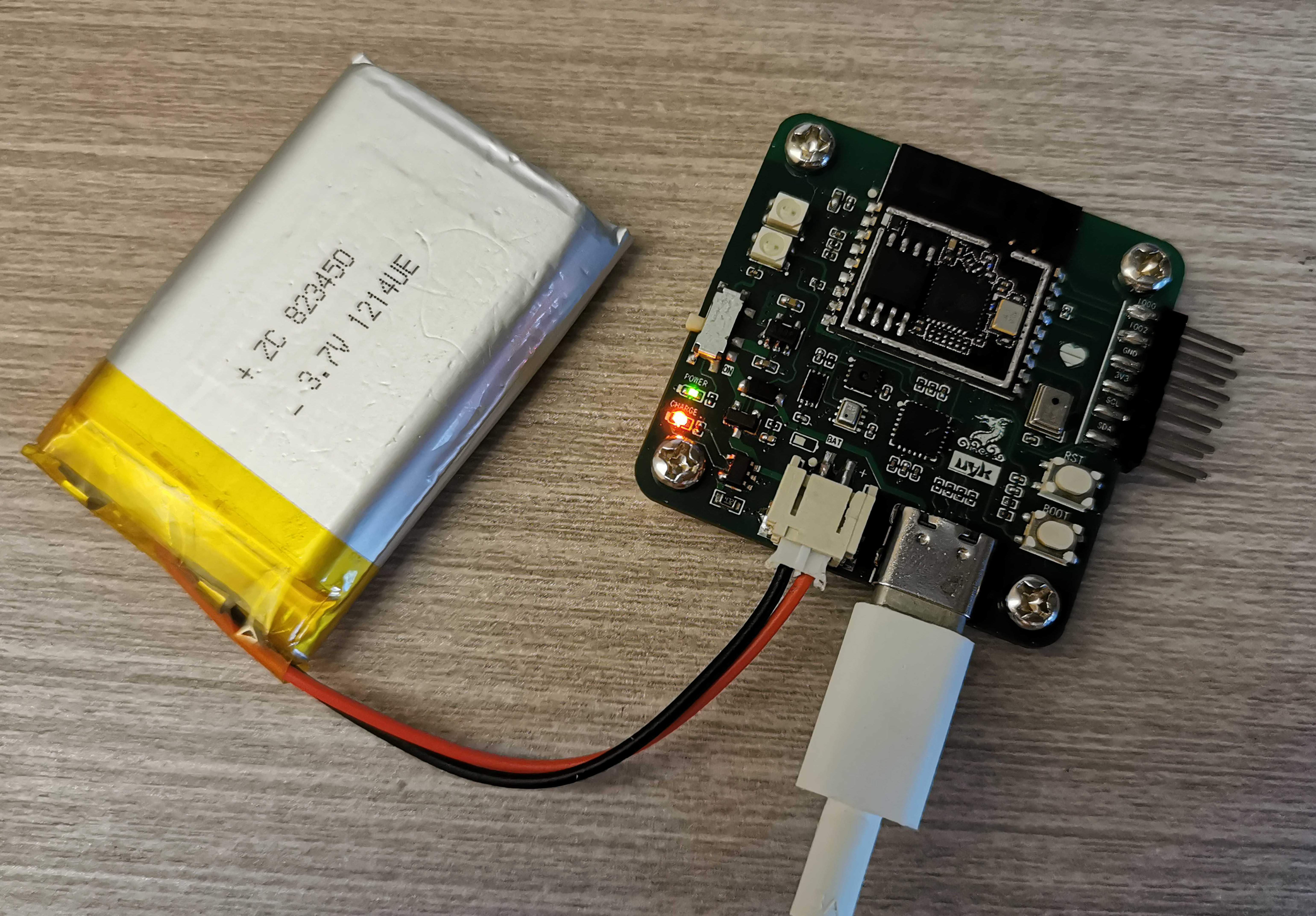

【ESP32C3】Mini development board
【Verified】
Download interface:
typec - built-in USB
① Because built-in USB is used, Mircopython, LuatOS, Platformio (Arduino) are not available, only espidf can be used.
② Because the built-in USB is used, after pressing the RST button, the chip is reset and the serial port connected to the board on the computer will be disconnected and needs to be reconnected manually.
Onboard resources:
  • Light sensor BH1750
  • Temperature and humidity sensor SHT30
  • Atmospheric pressure sensor BMP280
  • Inertial sensor MPU6050
  • Lantern WS2812(3528)
  • Silicon wheat MSM261S4030H0R
  • Lithium battery charging and discharging circuit
  • Power supply automatic switching circuit
encapsulation
It is best to use a heating table for welding
  • Resistance and capacitance: almost all 0201
  • Chip: mostly small packages such as QFN
