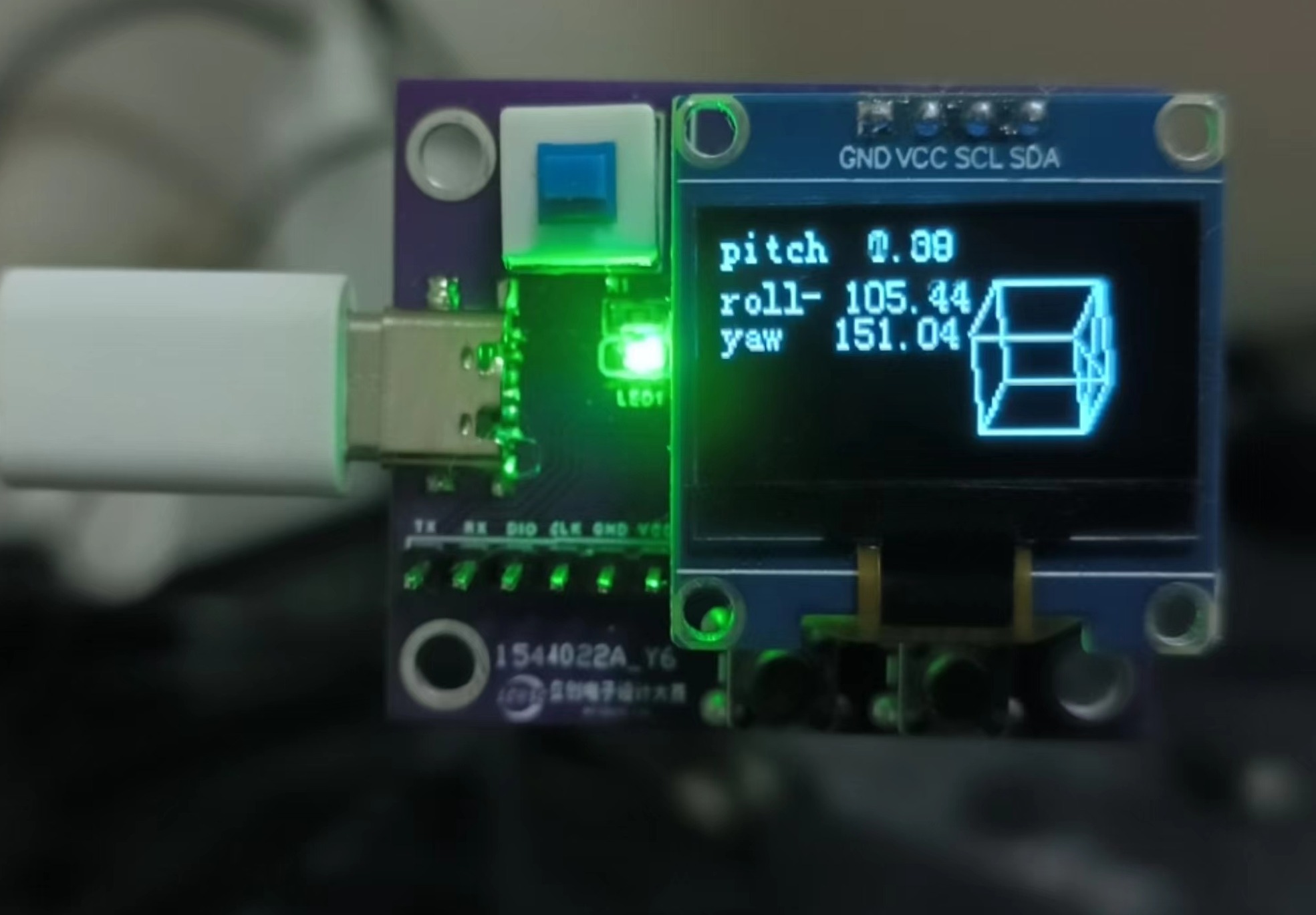

refers to the official routines and makes minor modifications. The peripheral modules use pins to connect the PCB, so that the PCB can be stacked to make it smaller.

power supply module: 5V power supply is provided through the TYPE-C port, and then 3.3v power supply is provided for MCU, OLED display, and MPU6050 through ASM1117-3.3.
MCU: Choose N32G430C8L7 of National Technology, the organizer of this training camp, as the main control, control the OLED display screen through the IIC interface, and obtain the data of the MPU6050 sensor through IIC for processing and then display.
*5.
The official example program used in the software part is compiled in keil5 and burned with DAP.
