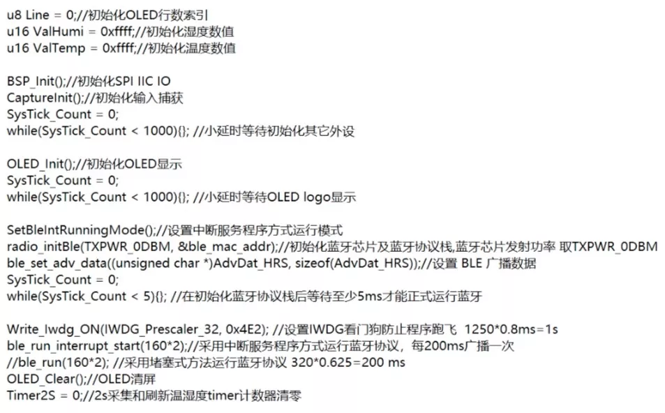

The following is the main function to initialize the configuration content. It mainly initializes all peripheral resources and Bluetooth protocol stack, and runs Bluetooth in the way of interrupt service routine. The code is as follows:

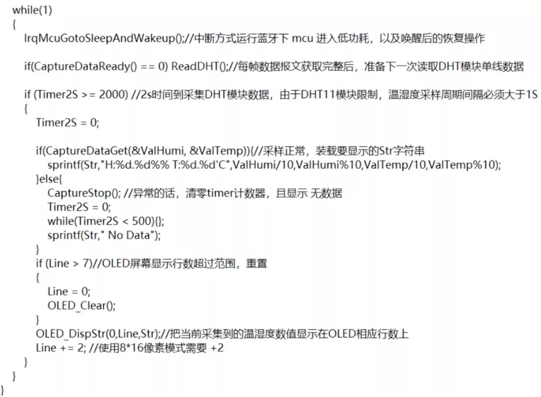

The main function implemented in the loop of the main function is to regularly collect and display the temperature and humidity data of the current environment, and this data will also be sent to the APP for display in the Bluetooth service . The code is as follows:

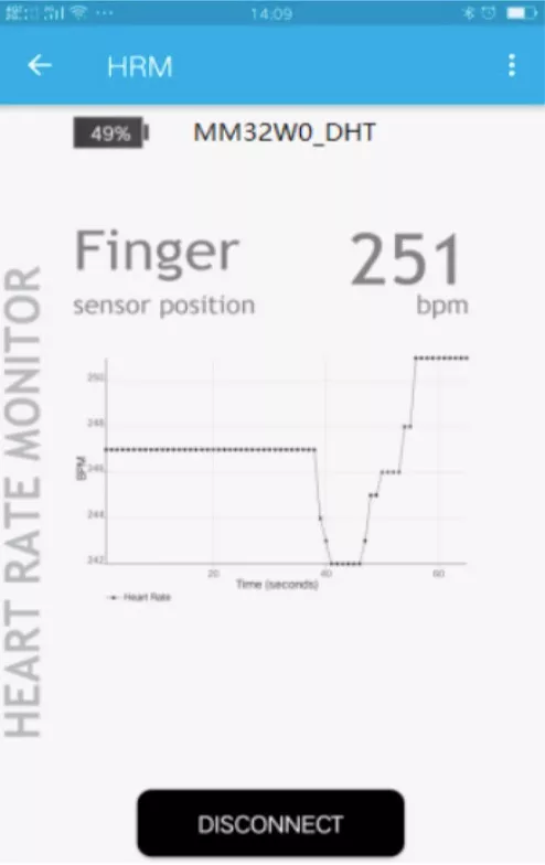

The mobile phone operation process is as follows:
Turn on Bluetooth on your phone and open the App , select HRM to enter, and click the Connect button to start searching for temperature and humidity Bluetooth devices.
Select the Bluetooth device with the corresponding name ( MM32W0_DHT ) and pair it, waiting for the connection to be successful. After the connection is successful, there will be a corresponding prompt, and the name of the button Connect will change to Disconnect .
After successful connection, the battery icon on the App interface will display the humidity information (percentage) obtained from the DHT11 sensor. The finger and chart will display the temperature information obtained from the DHT11 sensor (raw data, temperature value x10 ).
