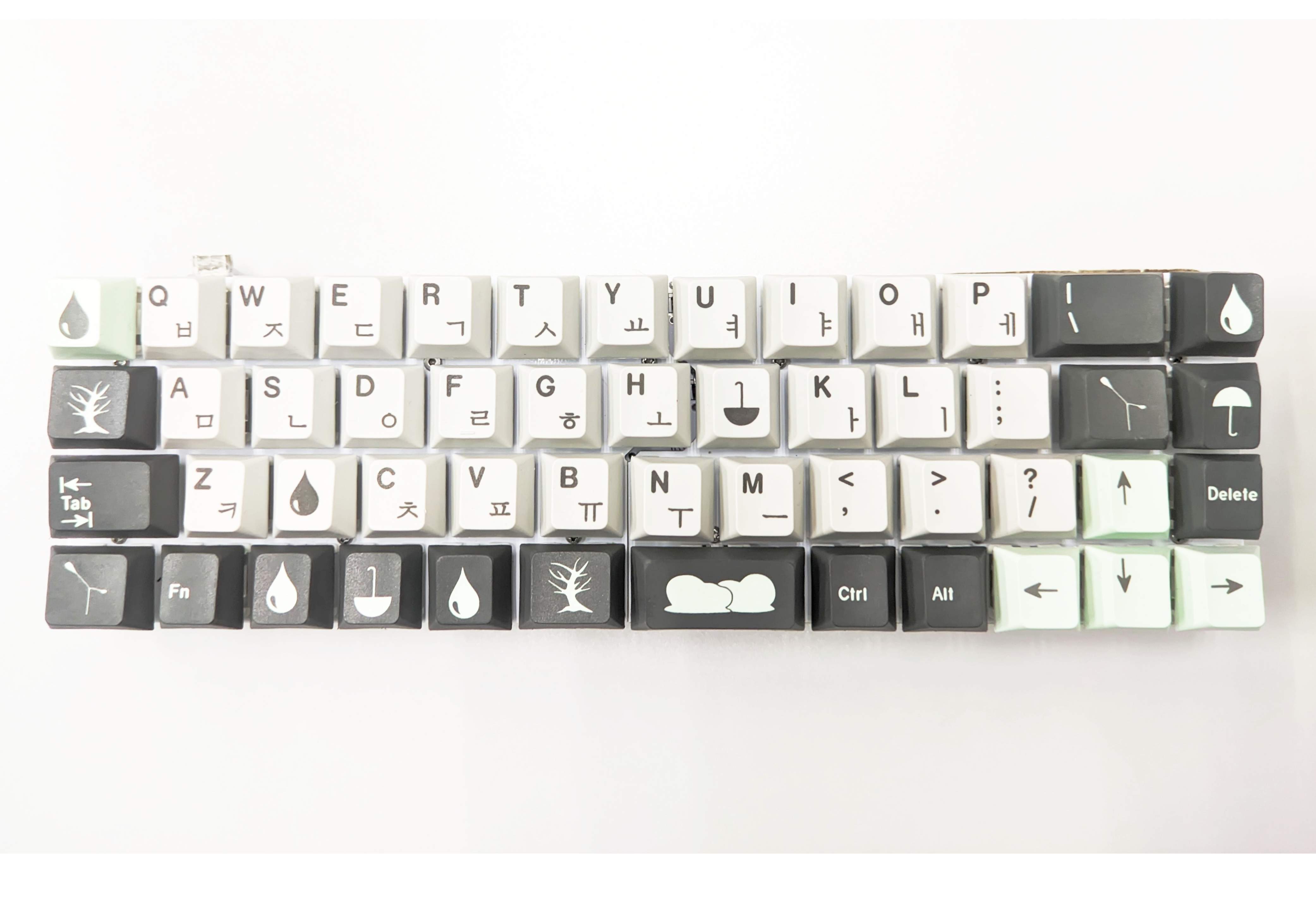

Verified, see the attachment for Gerber, firmware, and firmware source code
⚠️Auto-routing warning
⚠️Dirty board warning
Series Notes
(1) Zero-based assembly of open source keyboard
(2) Draw your own drawing board and have enough food and clothing
keyboard list
Fake split keyboard (orthogonal)
Dimensions (unit: cm)
name | long | Width |
PCB | 25.718 | 7.62 |
Positioning plate | ||
base plate | ||
Positioning plate (left) | 13.811 | |
Positioning plate (right) | 13.335 |
material list
serial number | Essential | name | quantity | Remark |
1 | ✓ | 1N4148 plug-in diode | 51 | |
2 | ✓ | Shaft | 51 | |
3 | ✓ | Kaihua hot-swappable shaft base | 51 | |
4 | ✓ | Pro Micro Development Board | 1 | Buy one that comes with BootLoader |
5 | △ | 12pin pin header | 2 | It is used to connect the development board and PCB. It is usually given when buying a development board. |
6 | △ | 40pin header | 1 | It is convenient to disassemble the development board; cut it into 2x12pin for use; if you use a female header, you need to buy the corresponding pin header, or use the cut diode pins |
7 | PCB Satellite Axis | 1 | ||
8 | ✓ | Positioning plate | 1 | |
9 | ✓ | M2 screw | twenty four | 12 holes on the positioning plate + 12 holes on the bottom plate, recommended heights 5mm and 10mm |
10 | ✓ | M2 nut | 12 | Height 10 mm or more |
11 | 4.5x4.5mm four-pin chip micro switch | 1 | Used for short-circuit-free brush firmware; height below 6mm |
