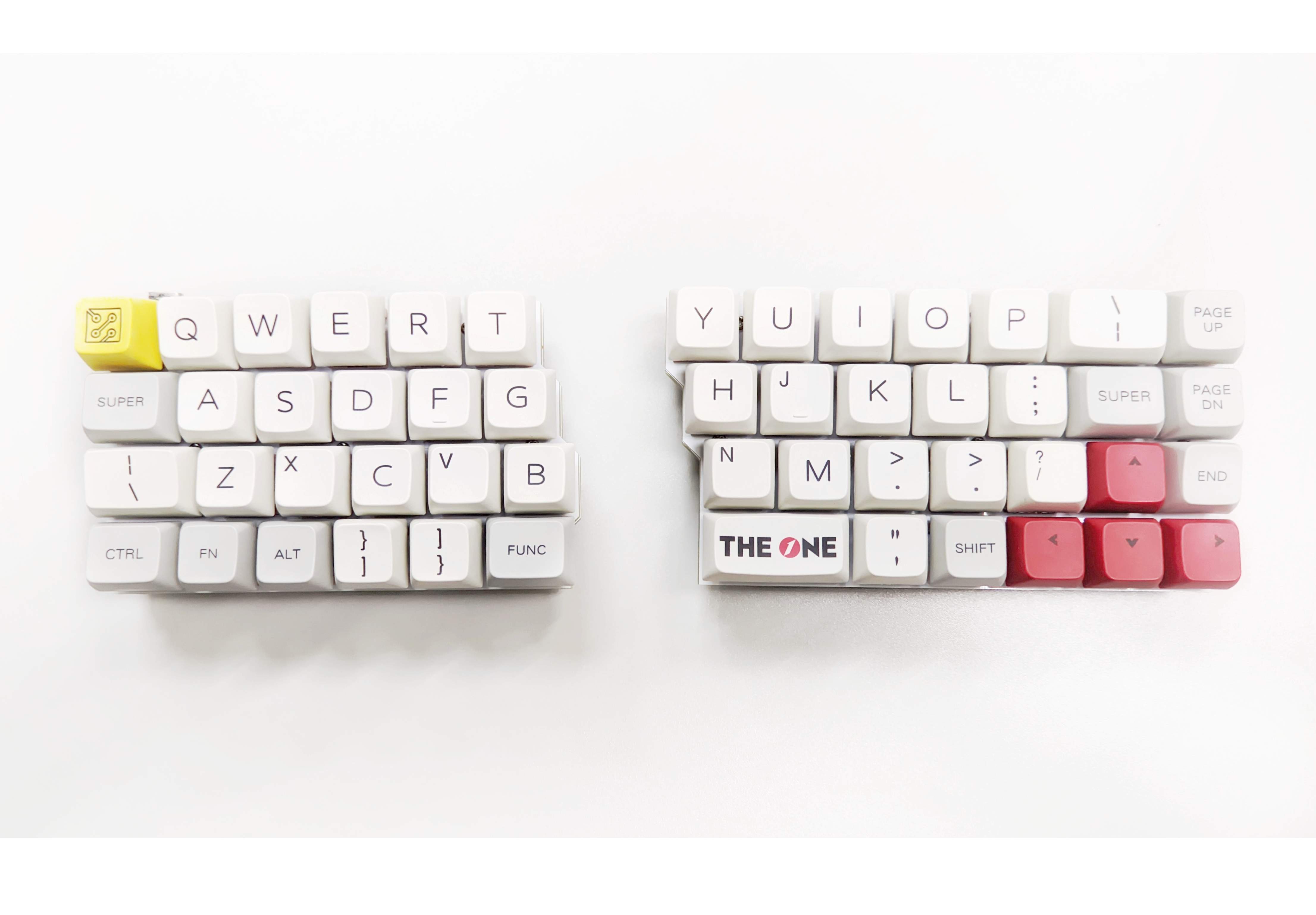

(1) Zero-based assembly of open source keyboard
(2) Draw your own drawing board and have enough food and clothing
keyboard list
Fake split keyboard (orthogonal)
Dimensions (unit: cm)
Location | name | long | Width |
Left | PCB | 12.382 | 7.62 |
Positioning plate | |||
base plate | |||
right | PCB | 14.288 | |
base plate |
material list
serial number | Essential | name | quantity | Remark |
1 | ✓ | 1N4148 diode | 51 |
SMD type (1N4148 LL34 1206) |
2 | ✓ | Shaft | 51 | |
3 | ✓ | Kaihua hot-swappable shaft base | 51 | |
4 | ✓ | Pro Micro Development Board | 2 | Buy one that comes with BootLoader |
5 | △ | 12pin pin header | 4 | It is used to connect the development board and PCB. It is usually given when buying a development board. |
6 | 40pin header | 2 | It is convenient to disassemble the development board; cut it into 2x12pin for use; if you use a female header, you need to buy the corresponding pin header, or use the cut diode pins | |
7 | ✓ | Positioning plate | 2 | |
8 | ✓ | M2 screw | 32 | Recommended height 5mm and 10mm |
9 | ✓ | M2 nut | 16 | Height 10 mm or more |
10 | 4.5x4.5mm four-pin chip micro switch | 1 | Used for short-circuit-free brush firmware; height below 6mm |
