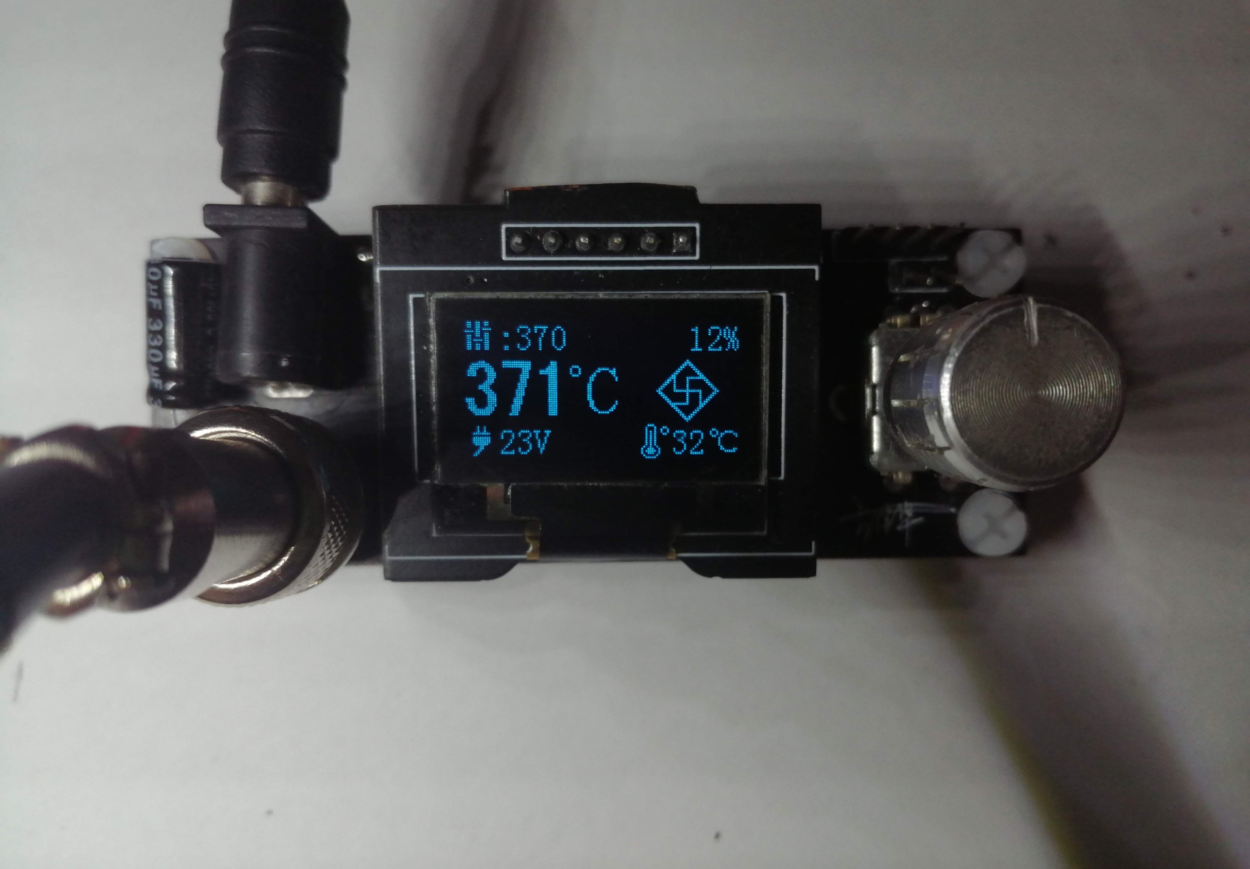

Hee hee, I bought this T12 from my senior brother and painted it according to the painting of a gourd. I planned to use it to learn wiring from Mo Gong, but I didn’t expect it to be rated, hahaha... The board above the picture is I used to use AD to draw with my senior brother. I used a 0.96 OLED. I saw on his board that he used a 1.3 OLED. I was often confused by his amazing operation.
The power supply I used is 24V 3A, which I bought from Xubao.

Oh, I almost forgot! I also bought the handle from a certain store. I bought a set directly and soldered a vibration sensor when I came back. Just pay attention to the wiring sequence (solder according to the PCB navigation plug) ~~~~
