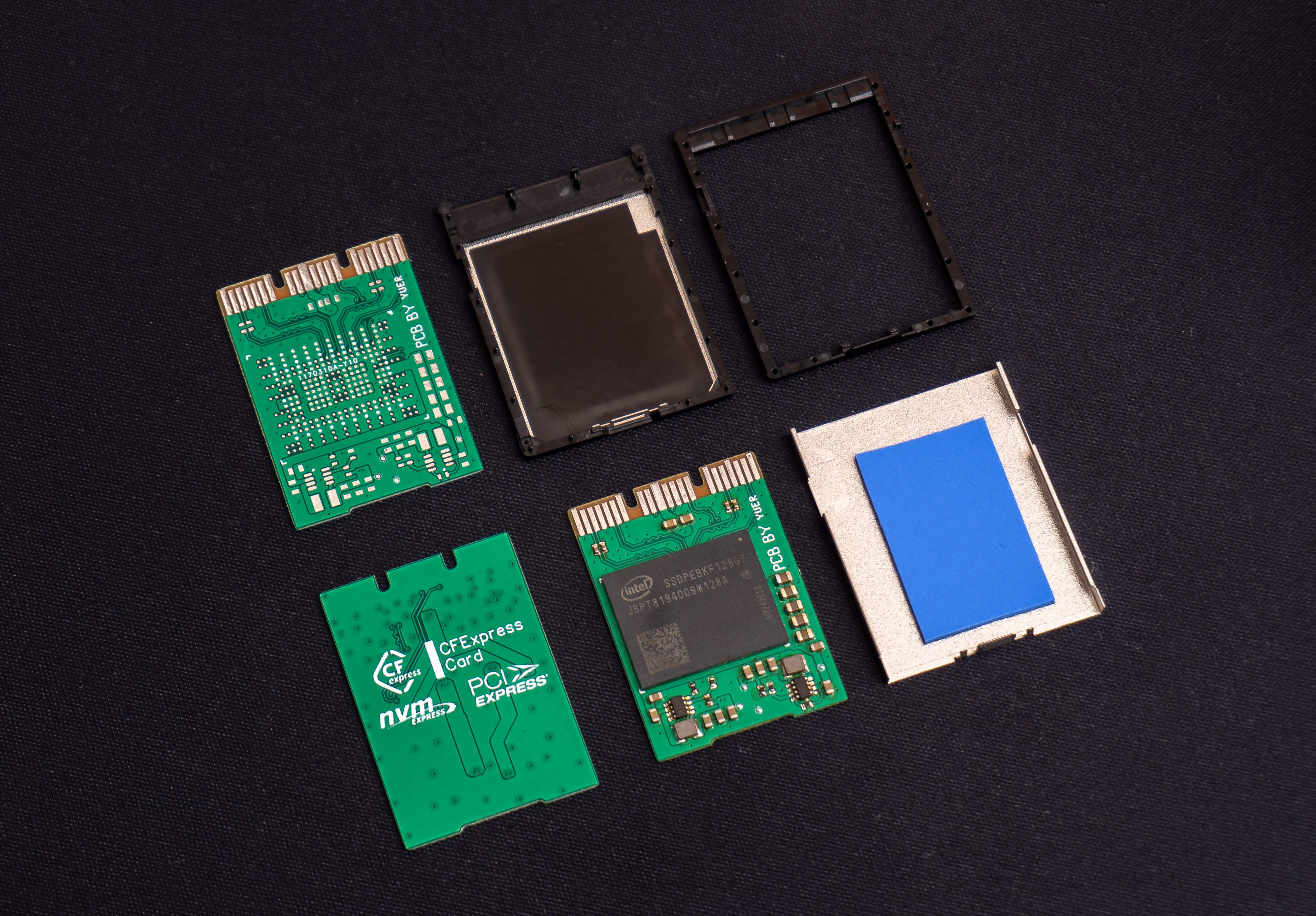

As the title shows, BGA291 (1620) packaged NVME solid-state particles can be transferred through the project's base plate to make a CFExpress Type B memory card.
For example, Toshiba BG3 BG4, Hynix BC501 511 711, Intel (surface onboard solid state), etc. are all BGA291 packaged solid states.
At present, it has been tested and the official version has been iterated in several major versions. It has almost reached a stable and usable state. If you have any questions, please give us feedback.

Choose a thickness of 0.6mm for the board, preferably a immersed gold PCB. It is best to buy a feedback resistor with an accuracy of 1%.
You can buy steel mesh from Xubao, and you can buy CFExpress casing from Xubao. I also bought some in bulk from the manufacturer here, and the price is 25 sets, which is cheaper than 35 yuan per set from Xubao.

It is currently known that Samsung, Hynix, Toshiba, and Intel have different power supply definitions, so each version will draw the board independently, and the update progress will be slower in spare time.

Actual picture (the version may be different, not necessarily the picture display of the current version)
The version shown in the picture is the 1.2 Toshiba base. The silk screen has not been changed yet. Let’s consider it the Toshiba version of the beta base.
