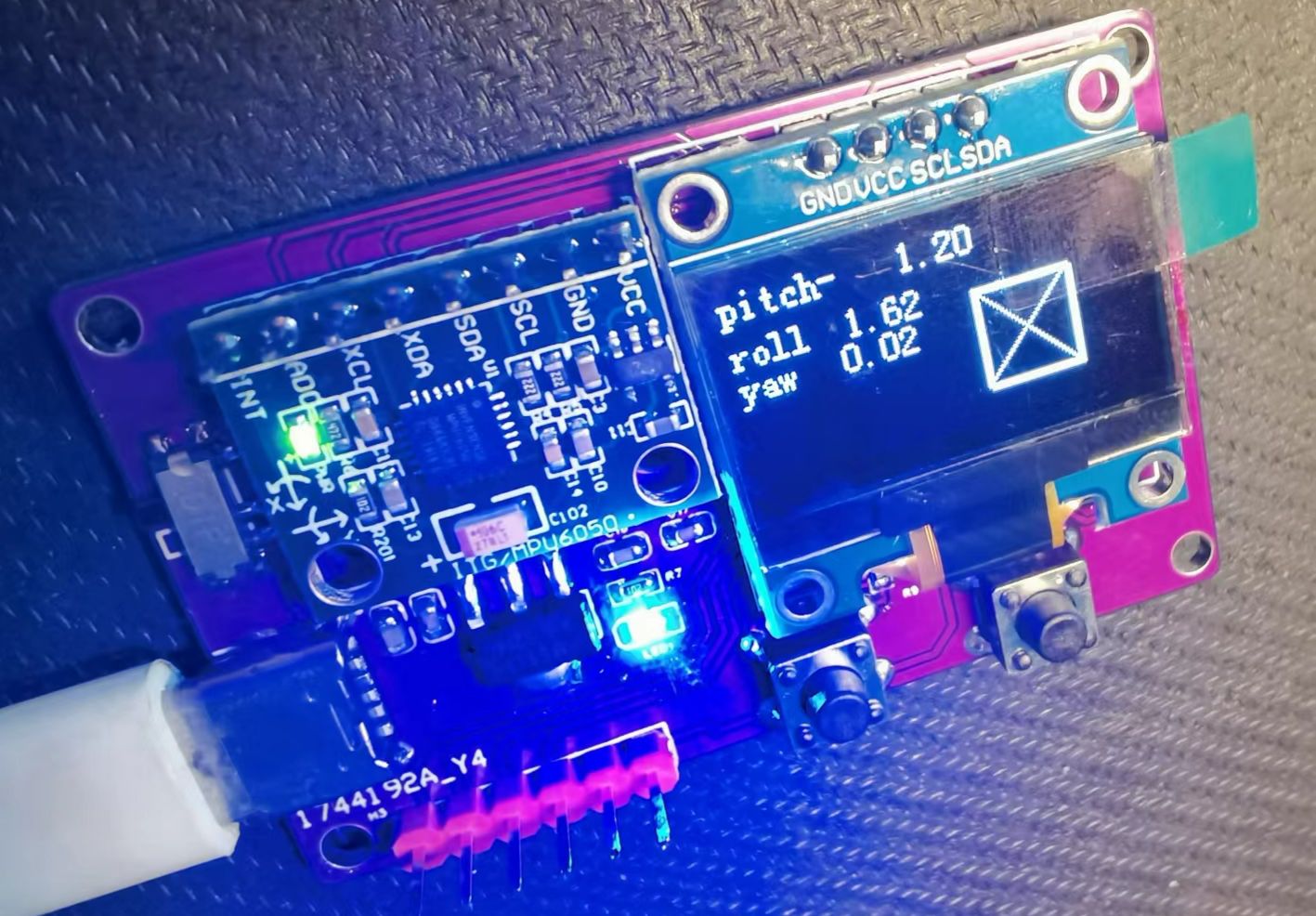

Based on N32G430C8L7+INA199, it collects attitude data and converts it into the real-time attitude of the module and displays it on the OLED.
It is mainly divided into the following parts: host computer, main controller N32G430C8L7, MPU6050 sensor, and OLED display module. It is designed to use the MPU6050 sensor to collect the original acceleration and gyroscope acceleration. The N32G430 receives the data and converts it into the attitude of the module. , displayed using OLED and host computer.

MPU6050 initialization configuration process:
1. Initialize IIC interface
2. Reset MPU6050
3. Set the full-scale range of the angular velocity sensor (gyro) and acceleration sensor
4. Set other parameters
5. Configure the system clock source and enable the angular velocity sensor and acceleration sensor
OLED initialization configuration process:
2. Turn off the OLED display and set the OLED register parameters
3. Turn on OLED display
(Reference document: https://wenku.baidu.com/view/fb23e3a4bfeb19e8b8f67c1cfad6195f302be849.html)
The spatial coordinate conversion algorithm can be found on Baidu.
Software initialization process:
-log_init(): 500000Bd, no parity, 8-bit data, 1 stop bit
-i2c_master_init ()
-oled_init()
-MPU_Init()
-mpu_dmp_init()
