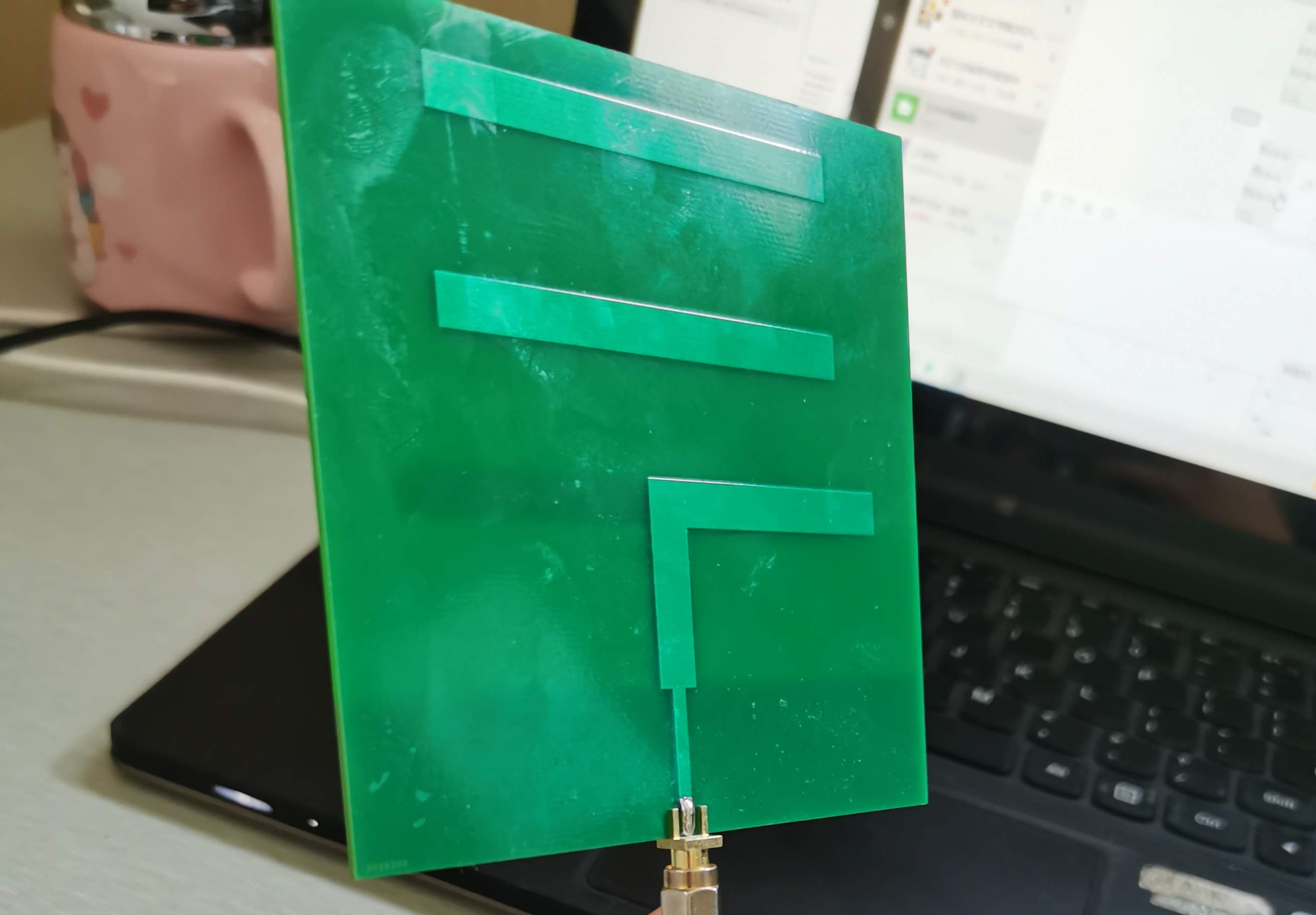

Target antenna (Figure 1 below): 1420MHz resonance, S11 parameters
Figure 1: The front and back sides of the Yagi antenna
S11 parameters of antenna
The red curve is the simulated S11 parameter, and the yellow and green curves are the two measured S11 parameters. It can be seen that the antenna can work normally around 1420MHz, with a bandwidth of about 50-70MHz.
Figure 2: S11 parameters
Figure 3 shows the scene during the two measurements. The equipment used was NanoVNA. The left picture corresponds to the green curve in Figure 2, and the right picture corresponds to the yellow curve in Figure 3.
Figure 3: The scene of two measurements
