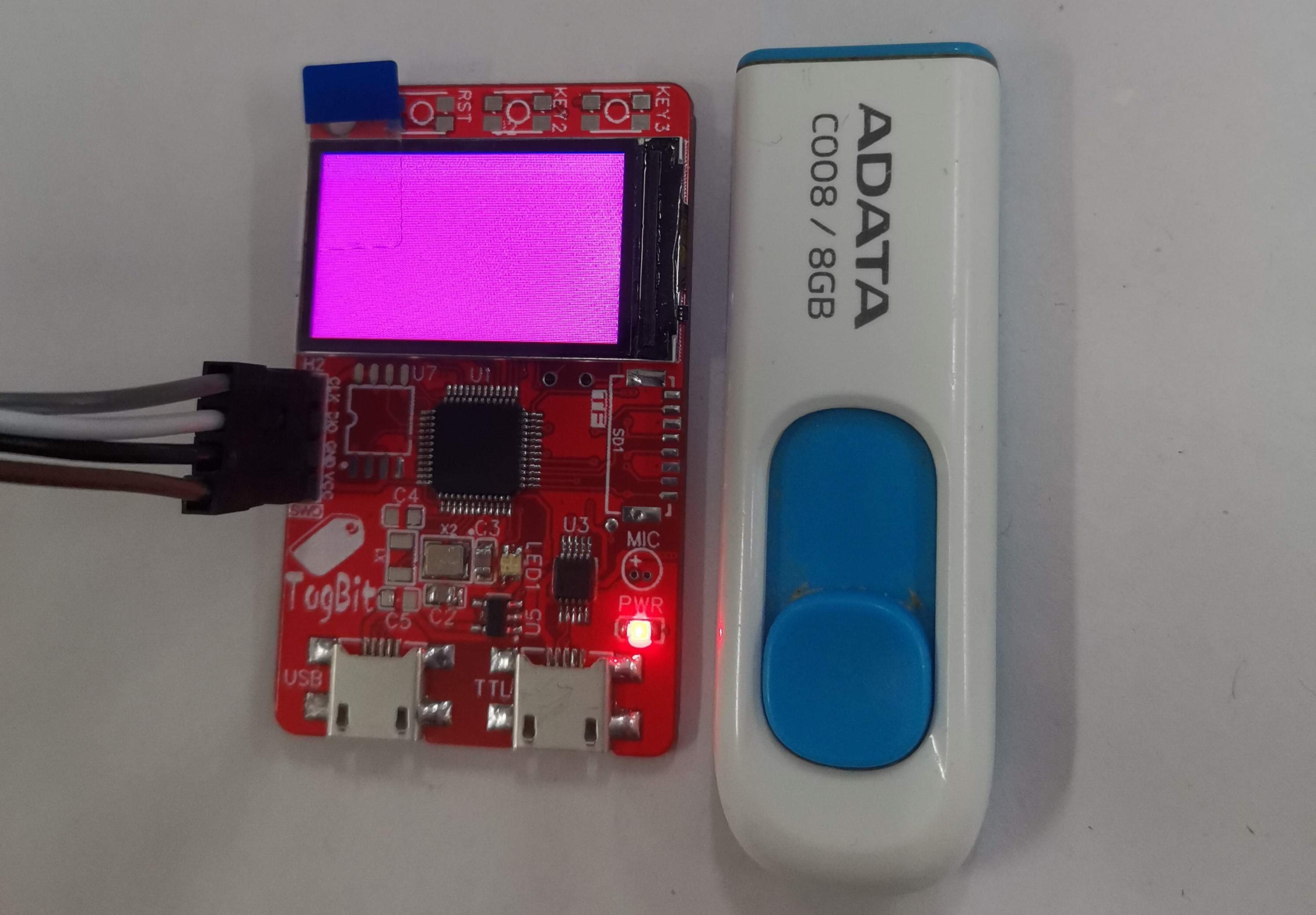

The size is only the size of a U disk. Onboard resources: 1.14 IPS TFT+TF card+MIC+Audio (DAC implementation, onboard power amplifier)+RGB LED+2*key+NorFlash+USB+CH340. Unfortunately, the onboard MCU The memory cannot be transplanted to LVGL, but it is sufficient as a verification LCD board and can also be used as a small portable toy (the playability is improved after Lua is transplanted). A COCOPI project will be open sourced in the future. This project uses the Cortex-A7 core and the chip uses the Allwinner V3s solution. It is also a very mini board with a 1.14-inch LCD onboard.
Here is a simple attachment of the 1.14-inch IPS TFT initialization code:

Note that there is an offset in the brush function below:
void DisplayWindow(unsigned int x1,unsigned int y1,unsigned int x2,unsigned int y2,unsigned int color)
    x1+=40;y1+=53;
    x2+=40;y2+=53;
