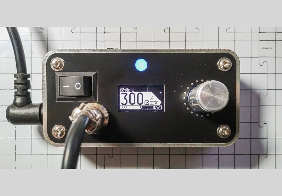

ESP32 T12 soldering station
The project is copied from the Zhuque T12 soldering station
1. Main changes
1. Main changes to the software part
1. Use PID control during temperature calibration
During temperature calibration, the original program heats when the current ADC is lower than the target ADC, and stops heating when it is higher than the target ADC. Use PID approach parameters instead
2. Modify the fitting algorithm
The original program fits the temperature curve y = f(x), x is the ADC value, y is the temperature, and f() is the polynomial. Change to fit V = E(T sense ) - E(T ref ), T sense is the hot end temperature, T ref is the cold end temperature, V is the thermoelectric potential, and E() is the thermocouple characteristic curve

4. Physical pictures
参考设计图片
