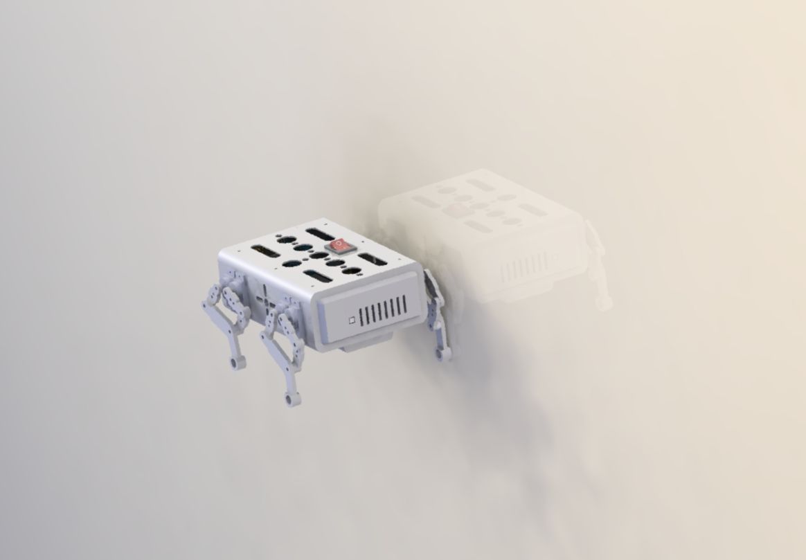

2.2 Mechanical structure design
2.2.1 Leg design
The dog's legs are connected in parallel using two servos. The end of each leg can move freely in the plane where it is located, so each leg has 2 degrees of freedom and the whole has 8 degrees of freedom.
2.2.2 Weight reduction design
In order to reduce weight, many textures are added to the design, which also has a beautifying effect.
2.3 Innovation part
The dog's leg structure is improved (using symmetrical design), the algorithm of inverse kinematics is re-introduced and simplified; a lighting control circuit is added to realize RGB flashing by controlling the IO port of Hi3861.
