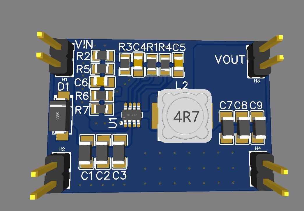

MP2315/MP2225
buck circuit.
1. Input 12V and output 3.3V/5V. The measured ripple is <100mV and the efficiency is over 90%.
2. Suitable for microcontrollers and various modules to power supply, the measured output current is 2A without pressure.
3. Cheap and stable (much better than some domestic 2596)
