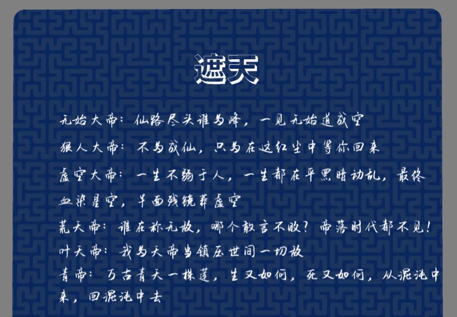

Collection of Ancient Imperial Orders (Hilbert Curve)
Introduction to Hilbert Curve
The Hilbert curve is a kind of curve. As long as the function is appropriately selected and a continuous parameter curve is drawn, when the parameter t takes a value between 0 and 1, the curve will traverse all the points in the unit square and obtain a space-filling curve. curve.
As you can see, the Hilbert curve is a very beautiful curve. We can use it to beautify our board and do some useful things. For example, this project ESP32 heating table uses Hilbert curve as a The wire produces a certain resistance and is used to generate heat.

  6. These are the only three places we need to modify. You can generate the pattern you want according to your own situation.
参考设计图片
