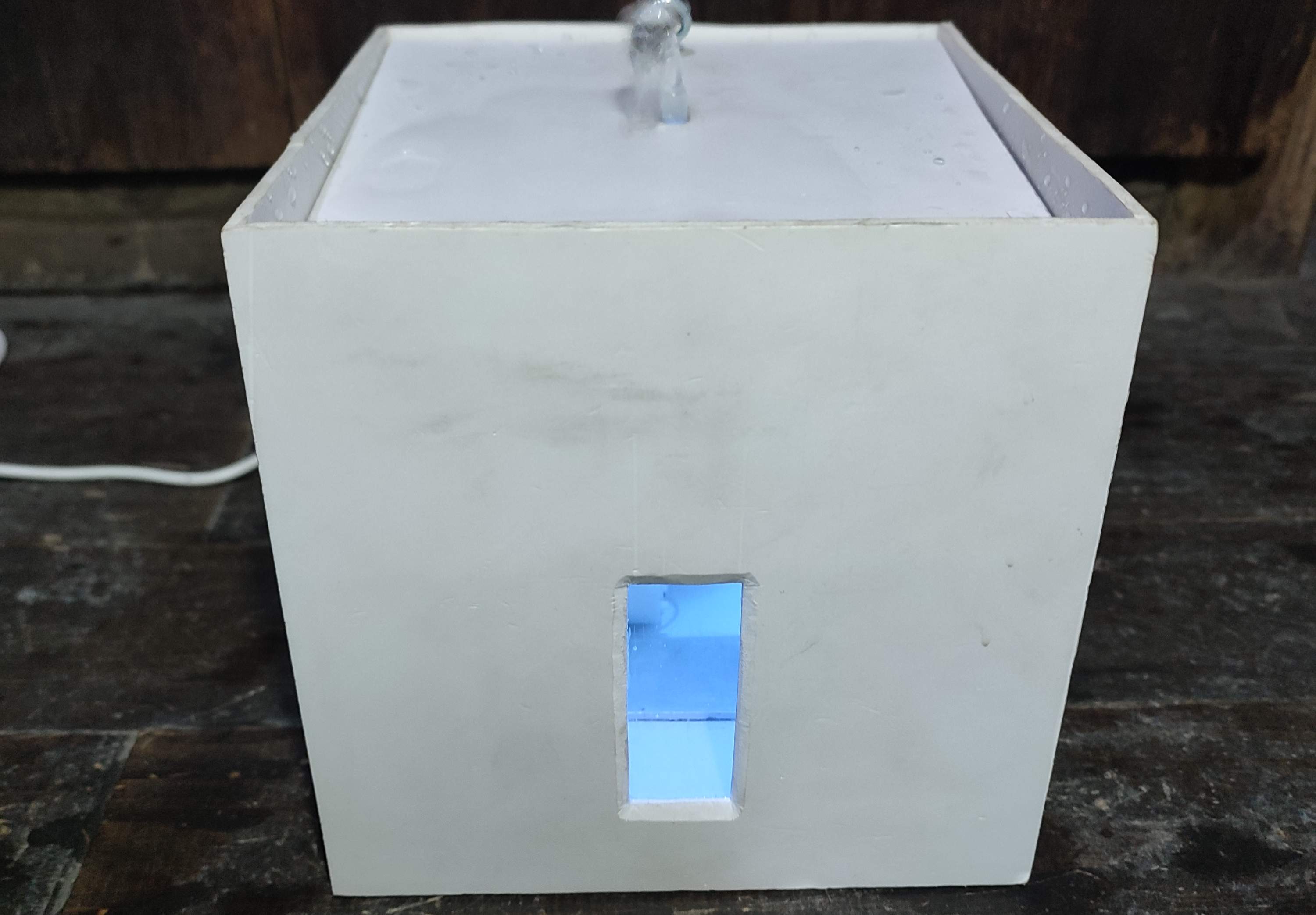

Pet water dispenser based on HK chip and Tuya module
Let me first show you the black and white impermanence of this cat.
Function:
* Flowing water attracts cats to drink, achieving the effect of drinking more water and reducing the probability of urinary stones.
* Water temperature detection can heat the water in the machine during cold weather to avoid the impact of too low water temperature on the cat's gastrointestinal tract.
* Water level detection, when the water level is too low, the light and APP will remind you to add water.
* Can control the flow volume and flow method. The cat is close to the water and keeps coming out of the water.
* UVC lamp beads can kill bacteria in water

                                            Color display of W S 2 8 1 2 indicator light in various situations
          Under normal circumstances,                  UV sterilization state              , heating constant temperature state,            water level is insufficient/just turned on
certainly ! , there are other colors ~~~·· Smart distribution network , WiFi is not connected . I didn’t expect it, just two , hahahahahahaha

In order to prevent water droplets from splashing, the small board has been waterproofed with UV glue .
The main board is fixed on the bottom of the cat water fountain with M2 screws, and is connected to the small board installed on the top with a ribbon cable. There are circles and circles on the top shell ~ I love you every day~~ .
Ah! I digress, that circle makes it easy to pick up the top cover, replace the filter, change water and clean it.
The filter is made of 80-mesh nylon mesh, which can filter cat hair and some stolen goods very well. And it is easy to replace and clean.
The joints and interior of the shell are all bonded with waterproof glue to prevent water leakage. And safe and non-toxic.
