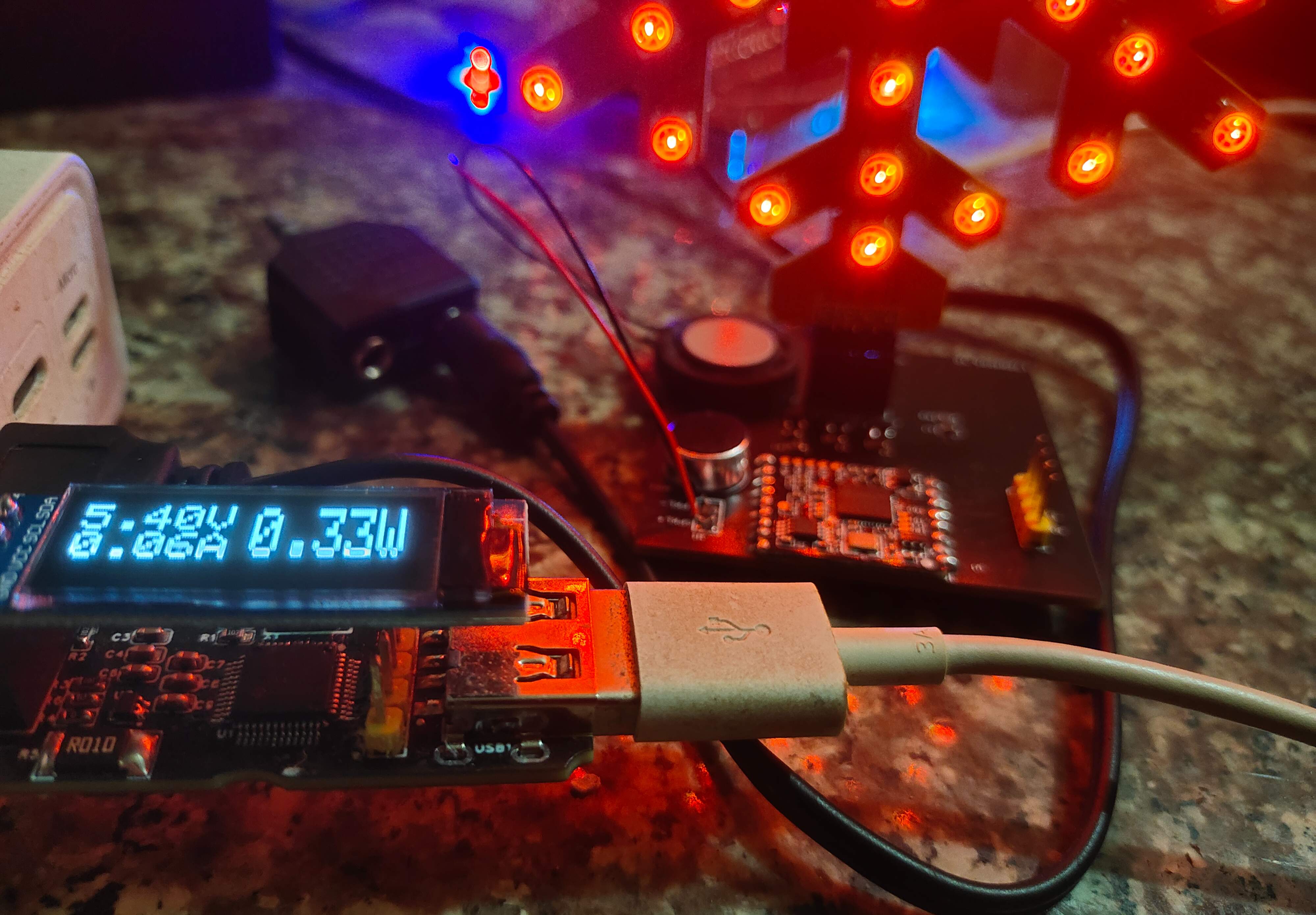

The project is mainly a reproduction of the functions in the summer training camp example, and the functions have not been changed much! The relevant valuable components have been replaced according to the components I currently have.
The USB ammeter made based on N32G430C8L7+INA199 has an accuracy of 1%, and can check the current when the USB is working.

*5. Competition LOGO verification and physical pictures
T4MnER6zr5Hg7nVvGzU83EMOaaokm00sVZHS5HEm.pngELMLgujX4fXCZ2SzQdXXqaeTmWDzgoGNDl4mP2sc.jpeg
YnH2uhUhjnYz4WDkWPp05k0I6LQ1Qefhero30BvY.jpeg9d37jpn6cB6vFcaSImIZF0OPhTQlhQvubuFtf1eJ.jpeg*6. Demonstrate your project and record it as a video and upload it
