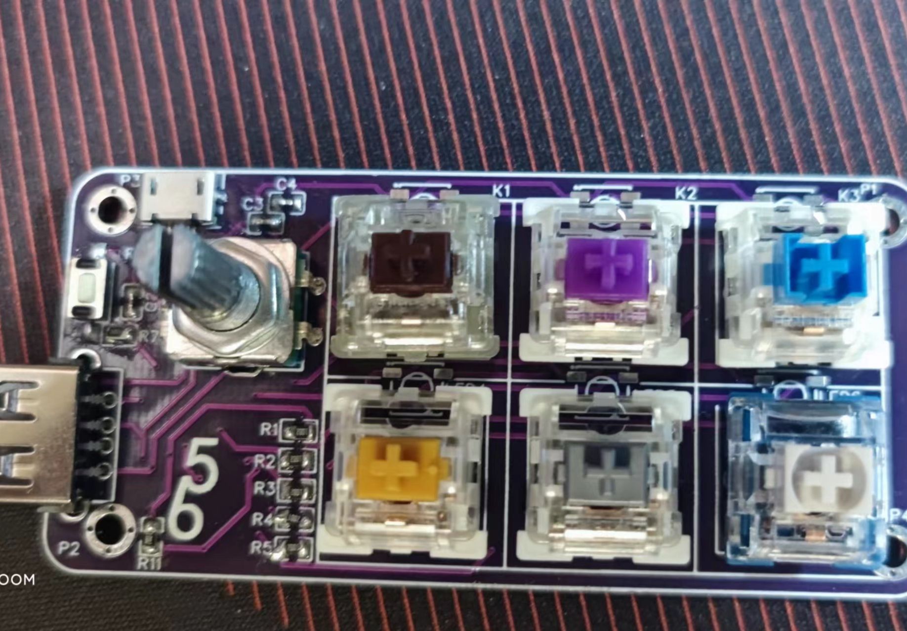

I have made a few modifications to the original project, optimizing the layout, adding axis seat hot-swapping, etc. However, there is a problem with the program of the original project. Adding a pull-down resistor still cannot solve the disconnection problem, so it is not recommended to use it (I don’t know how to write software... …)
Can anyone help me change the original author's program?
This is the finished product
Gerber is included in the attachment, you can just print the board directly

If you have already done it, you can burn this project.
https://www.oshwhub.com/TheLight/zi-ding-yi-jian-pan
The ec16 hex file attached to the later project can use at least 4 keys and does not drop the connection.
