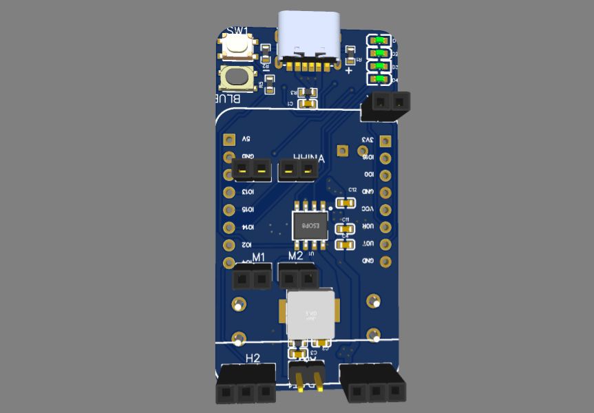

An extended version developed for esp32cam, which facilitates the development of wifi video cars in the smallest size.
The accessories are cheap, the cost is low, and the later wiring is simple. Just connect the motor and lithium battery.
L298N link https://item.taobao.com/item.htm?spm=a1z09.2.0.0.53ce2e8dx5znVe&id=656162803379&_u=o6a97t759f3
There are many tutorials for the esp32-cam firmware in the evening, so I won’t post them anymore. You can also search on the open source platform for how to burn them.
Pin definition: Motor 1 pin: IO13 IO12 Motor 2 pin: IO14 IO15 Servo H1: IO2 Servo H2: IO4
