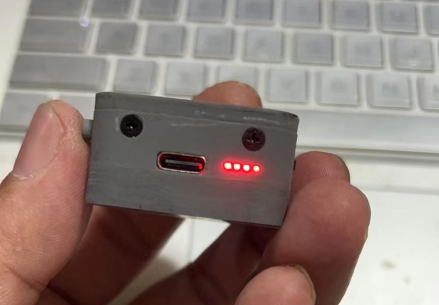

This machine uses a pulsator switch for up and down and confirmation operations, which is more convenient and space-saving than a button switch. This version is equipped with a 3D shell to improve the appearance and beauty. You need to pay attention when welding. If possible, use the burning tool to first install the ESP8266 Flash the BIN file, because I tested the onboard flashing method without success. Because I have a burning tool at hand, the PCB has not been changed.
The buttons on the left are reset and download buttons, and the bottom is the switch. Open on a standalone machine, double-click to close
There is a management backend web, and the WiFi browser connected to the ESP opens 192.168.4.1
Management background: 192.168.4.1
