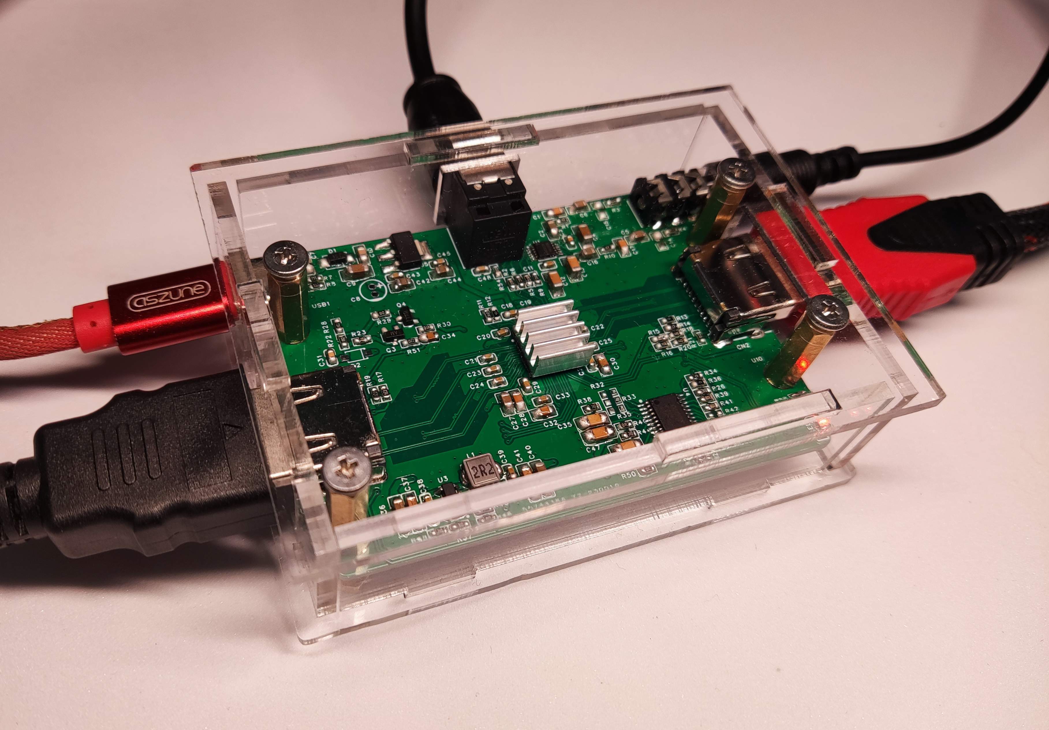

2. The circuit attention point
is mainly the input end here. The working process is: after HDMI is inserted, the voltage is divided to 3.3V through HDMI5V_IN. After the HDMIRXDET pin is detected, the MS9331 communicates with the input device to obtain EDID. After the communication is completed, the MS9331 will send a high-level signal from HDMIRXHPD back to the input device, indicating that the MS9331 is ready and can transmit data.
The HDMIRXHPD pin outputs only 0.7V, so two NPN tubes are needed for amplification. Note that the 3904 tube must be used here, and do not use other NPN transistors, otherwise the amplification parameters need to be readjusted. The HDMI part adopts 100 ohm impedance, and the board thickness is 1.0mm
for free. 3. Chip purchase: MS9331 is controlled by IIC. As usual, the specification and register table of MS chips are not available. However, like the previous MS9332 and MS9334, Ma Yun has matching ICs for MS8005 for sale on the Internet, so you can use the ready-made ones without programming. https://item.taobao.com/item.htm?spm=a1z09.2.0.0.5f152e8dYHRKFr&id=691533336994&_u=hqavhl8b1f1 4. The acrylic shell is drawn using SolidWorks, and there are dxf and dwg screws that can be ordered directly : M3X6+6: 4 pcs M3X14+3: 4 pcs M3 copper hexagonal nut: 4 pcs cross thin head machine screw M3x6: 4 pcs Acrylic thickness of 3mm is not imported into the LiChuang panel project, because the LiChuang panel is more expensive, you can take it to Taobao, the price is about 25 (LiChuang does not have 3mm, even 2mm costs 30 and does not include shipping) 5. Summary MS9331 does not generate too much heat when in use, and you can add a heat sink depending on the situation. Recommended level of project: Hardware beginner ~ entry-level project cost: The main control chip will be more expensive by about 15, and the total cost below 20 is acceptable. The shell is about 25 yuan. Finally - I am not optimistic about the current use of switches (sad) and have joined the switch army (a mess). Left: Fiber 4 in 1 out switch: https://oshwhub.com/aknice/guang-xian-4-jin-1-chu-qie-huan-qi Middle and upper: High-speed USB3.0 sharer 4 in 4 out selection HUB + switch: https://oshwhub.com/aknice/vl822-ch484m-si-jin-si-chu-usb3-0-hub There is a USB2 version: USB HUB switch 4 in 4 out: https://oshwhub.com/Aknice/e3a68120fa8d49ff8bc50ad21d57ec9d Middle and lower: This project. Originally it was a 1 in 2 out and then VGA to audio out audio and output HDMI: HDMI in HDMI + VGA + analog audio out converter: https://oshwhub.com/aknice/ms9332-ms8005-demo Based on: HDMI to VGA: https://oshwhub.com/Aknice/79fa85e6986e4af98d808872469bf327 Can also be used 1 in 4 out: https://oshwhub.com/aknice/hdmi-1-jin-4-chu-tong-ping-qi Top right: HDMI 5 in 1 out switcher: https://oshwhub.com/Aknice/83d25e9c5f9240499dfcd01eeaa45b82 There is also HDMI 3-input 1-output switch: https://oshwhub.com/Aknice/1dfda80b41104751846aecc99dd9e055
