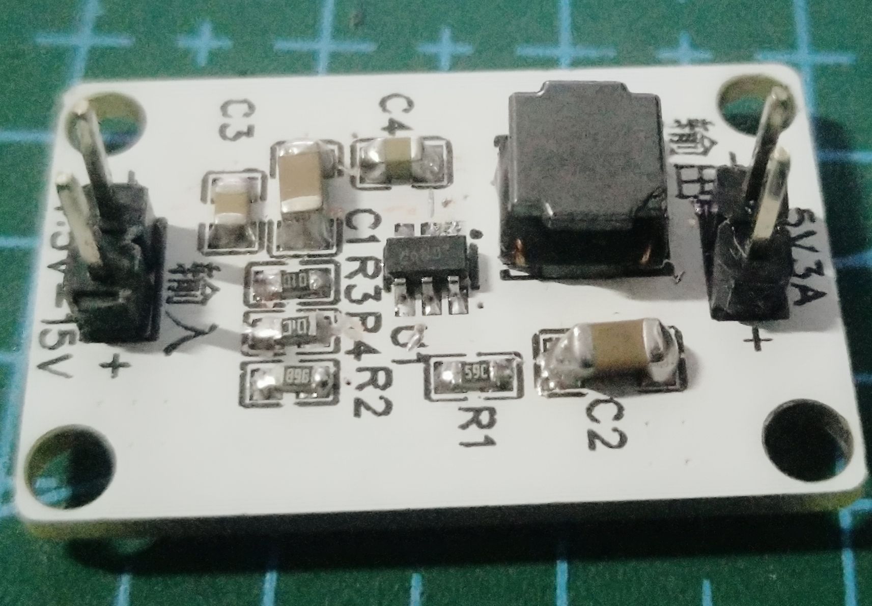

This design is a 5V3A step-down power module based on BL8033CB6TR .
BL8033CB6TR is a 4.2V~16V input, 3A, 500KHz, synchronous buck converter that does not require Schottky diodes. The circuit is very simple and reliable, so this solution uses the DC-DC power IC BL8033CB6TR from Lichuang Mall .
The input and output are led out through pin headers.
Shouldn't just leave the pins? It's too difficult for me.
The test works perfectly, and I will test the power performance later (not yet, and I don’t have the equipment) Demo video of station B
I used a multimeter to measure the power of the small motor connected and it was 5vx1.2A=6W. The input was 12V2A on the router.
