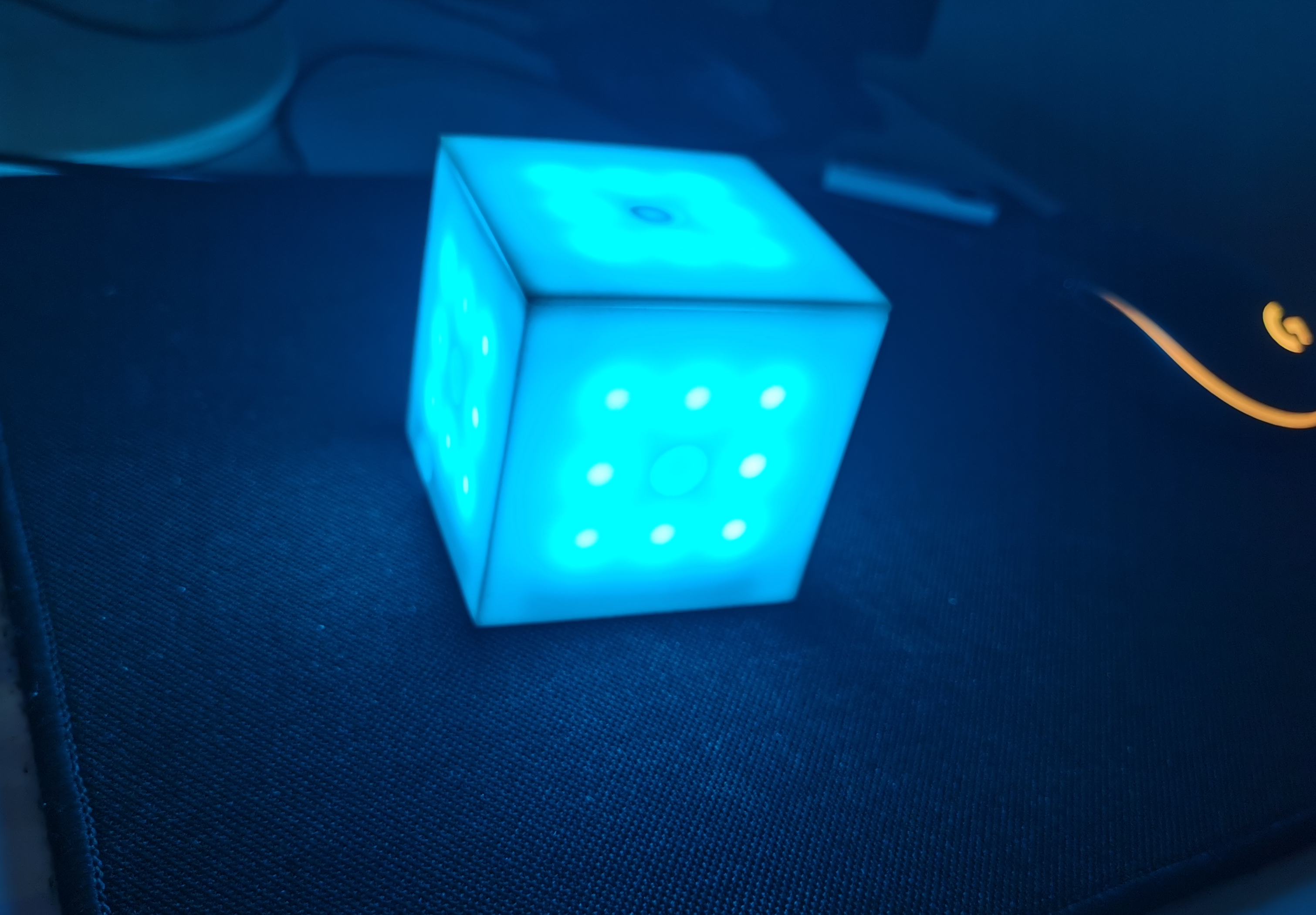

【RA】Multifunctional Light Cube
# Overview The master controller is Renesas’ R7FA2E1A72DFL. Use SPI to drive WS2812b. Use the touch buttons to switch modes. It can be powered by lithium battery or TYPE-C. The current implementation modes are as follows: 1. Breathing light, 2. Gradient light, 3. Light up one by one, 4. Pickup light, 5. Battery power display. # Parameters are measured when the supply voltage is 3.7V | Parameter | Unit | | --- | --- | | Quiescent current | 3uA | | Operating current | 300mA | ![IMG_20220507_150721.jpg] ![IMG_20220507_150904.jpg ] The charging current is about 520mA! [IMG_20220508_122546.jpg] # Installation ## First weld a bottom plate, a top plate, and four side plates. ![IMG_20220508_155822.jpg] (Touch springs can be welded around the side panel. The software debugging can recognize it, but it cannot run, so the touch on the top panel is reused. You can try the side touch) ## When plugging in, side There are up and down boards! [IMG_20220508_155855.jpg] ## Likewise, the arrow directions of the top and bottom plates need to be the same! [IMG_20220508_155937.jpg] ## Then fix the bottom plate to the shell with M2.5 screws! [IMG_20220508_160043.jpg ] ## Plug in the battery! [IMG_20220508_160113.jpg] ## Plug in the side panel! [IMG_20220508_160146.jpg] ## Plug in the top panel! [IMG_20220508_160924.jpg] ## Close the lid! [IMG_20220508_160931.j pg] ## Done, start up! ![IMG_20220508_160943.jpg] # Github https://github.com/Eason69/Cubic_light # The entire video of the effect demonstration cannot be uploaded. It must be uploaded in segments.
