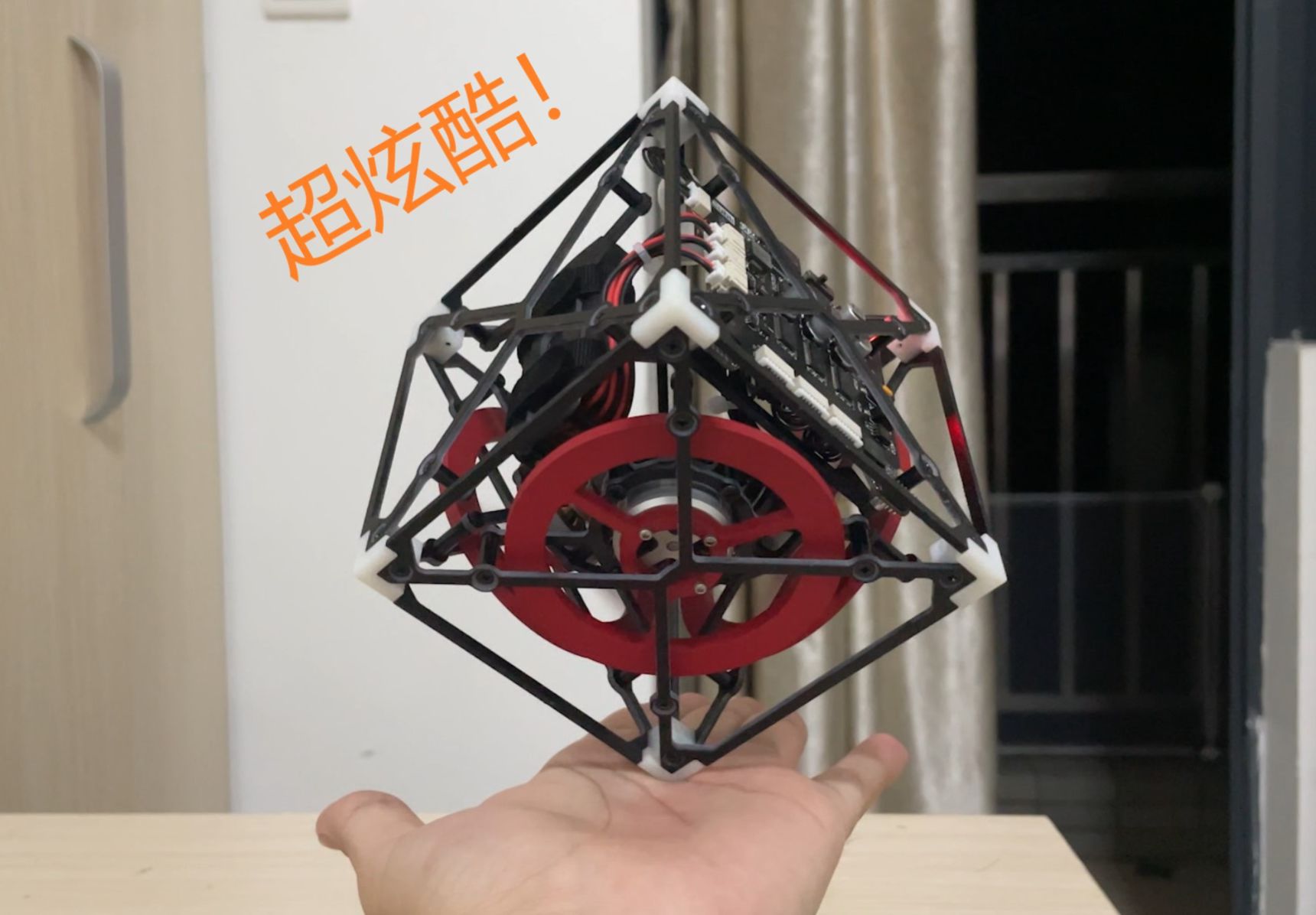

Who can resist a cool balancing cube Cubli_Mini?
The ID of this project comes from Cubli of ETH Zurich, and the motor driver uses Simple FOC. Low cost, small, and simplified as my first open source project
The project is completely open source. Anyone can use the Github content for free. Of course, you can also click Star
introduce
This project is based on the original Cubli, removing the active braking, reducing the size and making certain simplifications. It needs to be manually adjusted near the balance point to achieve edge and point balance. Cubli_Mini is a 10 10 10CM cube that integrates motor drive, charging and discharging. When fully charged, point balance can last for ≥5 hours without disturbance.
Project cost: ≤800RMB
Information description
  • 3D model design source file
  • Main control module, IMU module, encoder module, download module hardware engineering
  • Main Control 1, Main Control 2 Software Engineering
    • The main control module uses two ESP32
  • Network debugging assistant
    • WIFI parameter adjustment use
  • Various documentation descriptions
    • Some descriptions of the project, such as parameter adjustment, key operations, control principles, etc.
  • Proofing file
    • STL format 3D printing files
    • DWG format sheet metal files
    • BOM table
      • Structure BOM table
      • PCB components BOM list
structural design
Since I have only learned SW for a week, I will miss some details on some parts, such as screw threads, copper column internal threads, etc.
Sheet metal parts such as the outer frame are made of lower-cost fiberglass boards to reduce costs while ensuring rigidity. The momentum wheel is made of 304 stainless steel, which can provide a large moment of inertia in a small volume. Supplemented by a small number of 3D printed parts. The connectors use anodized aluminum posts for aesthetic reasons, but you can also use lower-cost copper posts yourself. The cost of the overall structural parts is less than 350 yuan, and the replacement of aluminum columns with copper columns can be reduced to less than 290 yuan.
