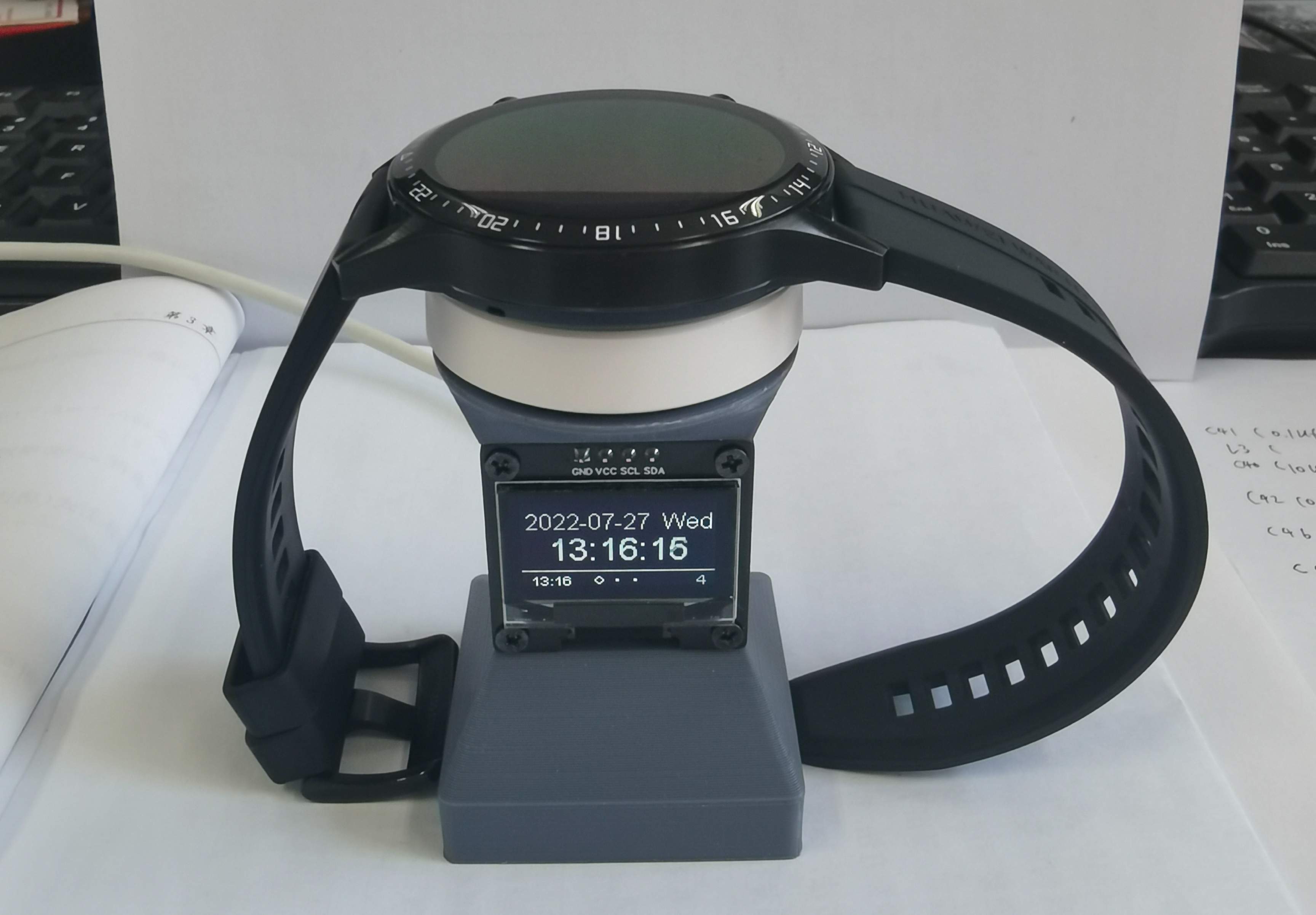

Upgrade content:
Two fixed blocks, upper and lower, are designed (there is a three-dimensional model in the attachment), which are connected to the original PCB module to form a watch charging bracket. A typec female base is installed at the tail for powering the watch charging base and clock module. After the upgrade, the clock module is lifted up by the fixed block, which gives a better visual appearance and enhanced stability when placed on the desktop.
Original content:
The content displayed on the screen is mainly the time, current weather and weather forecast. The code is modified based on the clock weather of Tai Chi Maker. The main reason is that the old version of Zephyr Weather is about to stop serving, so the attached code has been changed to the latest Zephyr Weather. Get the format.
The PCB of the screen was changed to a rounded rectangular shape based on the 0.96-inch screen of Plaza Technology Xiaoxin. I can’t appreciate the leaf-like shape.
The bottom PCB is added with a CH340C to facilitate downloading of codes (mainly because it is not used when it is idle, which is uncomfortable as an obsessive-compulsive disorder). There are two typec ports that can be selectively soldered to one end. Of course, you can also solder both, depending on your personal habits.
The upper and lower frames are the same size and can be fixed with M2*11mm copper pillars.
