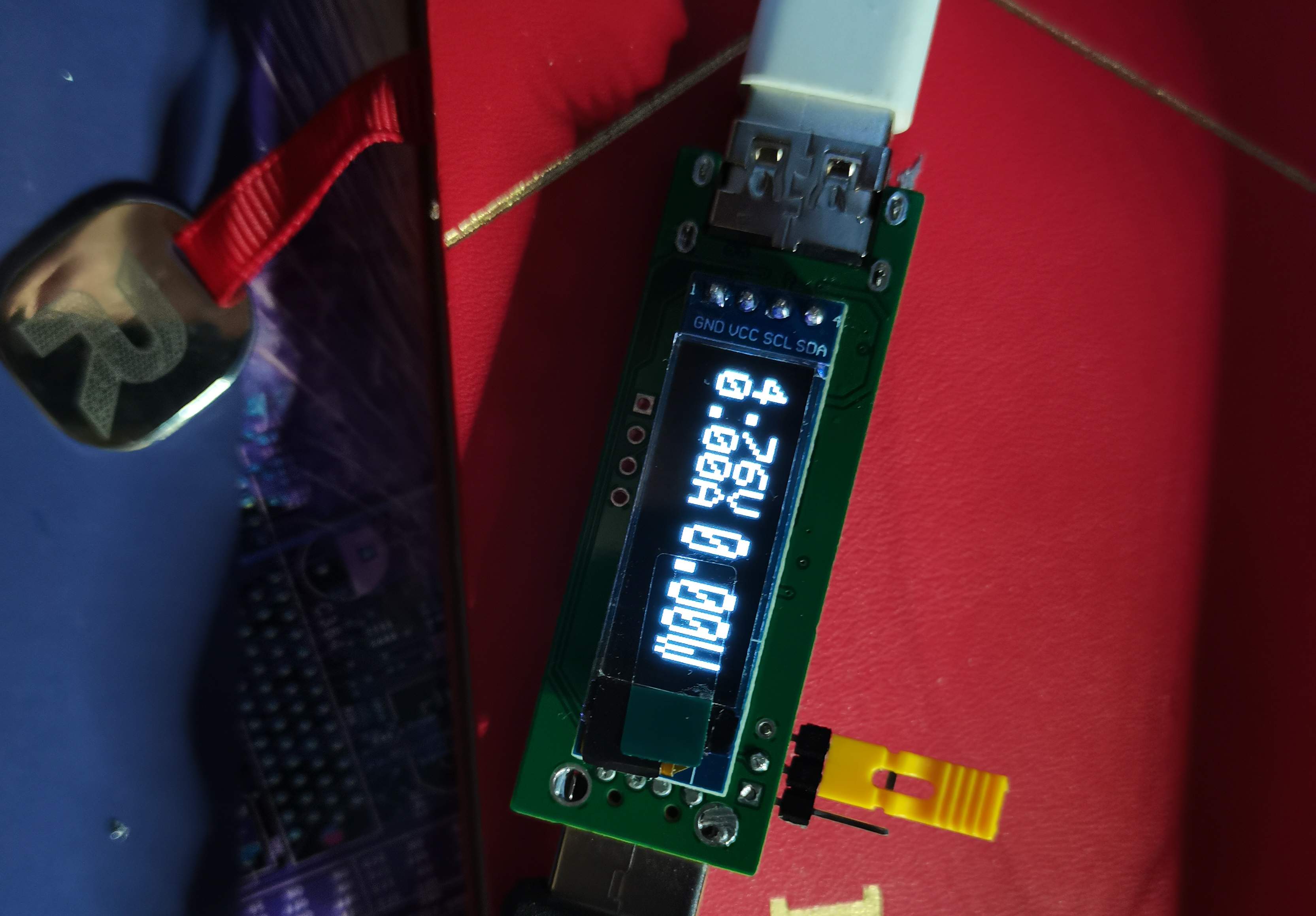

* 1. Introduction to project functions
A simple USB power consumption tester was made to detect the current on the USB device. By using TI's INA180A2 current sensing amplifier, the voltage on the current-sensing resistor is amplified, and then the amplified voltage is collected through the ADC on the N32G430, and then the current passing through the current-sensing resistor is solved by the program.

After completing the design of the minimum system, we have to start designing the sampling circuit. I did not copy the official sampling circuit in full. The main reason is that I have about 10 INA180A2 current sensing amplifiers. In order not to waste them, I still use the existing amplifiers on hand.
You can see that the circuit I circled in red is actually a filter circuit, because when collecting voltage signals, a lot of high-frequency noise will be introduced, and the sampling rate of the microcontroller is assumed to be 100K. After the FFT analysis of the collected signal, the maximum spectrum is 50K, so the noise outside 50KHz cannot be restored. Therefore, the front end of the sampling circuit will generally add an analog front-end circuit. This filter is to reduce the interference of high-frequency noise.
The output of INA180 is connected to the ADC of the microcontroller, and the ADC of the microcontroller is high impedance. The best filter is to connect an RC low-pass filter to the output of INA180, which will greatly reduce the output common-mode noise and the interference in the INA180 power supply voltage. However, adding an RC filter to the output will cause output attenuation, and before the amplifier is a differential signal, the best way to deal with differential signals is to start filtering at the input stage. The specific RC filter parameters can be referred to the figure below.
The addition of external series resistance will produce additional errors in the measurement; therefore, in order to reduce the impact on accuracy, the value of these series resistors must be kept below 10Ω. When a differential voltage is applied between the input pins, a mismatch in bias current will occur at the input pins. If additional external series filter resistors are added to the circuit, the mismatch in bias current causes a mismatch in the voltage drop across the filter resistors. This mismatch will produce a differential error voltage that will be subtracted from the voltage generated across the shunt resistor. This error will cause the voltage at the input pin of the device to be different from the voltage generated across the shunt resistor. If there is no additional series resistance, the mismatch in input bias current has little effect on the operation of the device. The amount of error added to the measurement by these external filter resistors can be calculated using the following formula:
Where the gain error factor is calculated using the following equation.
The amount of change in the differential voltage present at the input relative to the voltage generated at the shunt resistor is based on the value of the external series resistor (RF) and the internal input resistor RINT, as shown in the schematic diagram above. When the output voltage is compared to the voltage across the shunt resistor, the reduction in the shunt voltage reaching the device input pin is manifested as a gain error. A coefficient can be calculated to determine the amount of gain error introduced by adding the external series resistor. Calculate the expected deviation between the shunt voltage and the measured value at the device input pin.
I used the INA180A2 current sensing amplifier, which has a gain GAIN of 50, an internal resistor RINT of 10KΩ, and Rf of 10Ω. The Gain Error Factor formula gives:
CZp2dRglvFPjvpUHXbdHNE2rhuwbPfdmfApwL1W7.pngThen using this filter will cause some gain error, but don't worry, you can calibrate the error later in the program.
