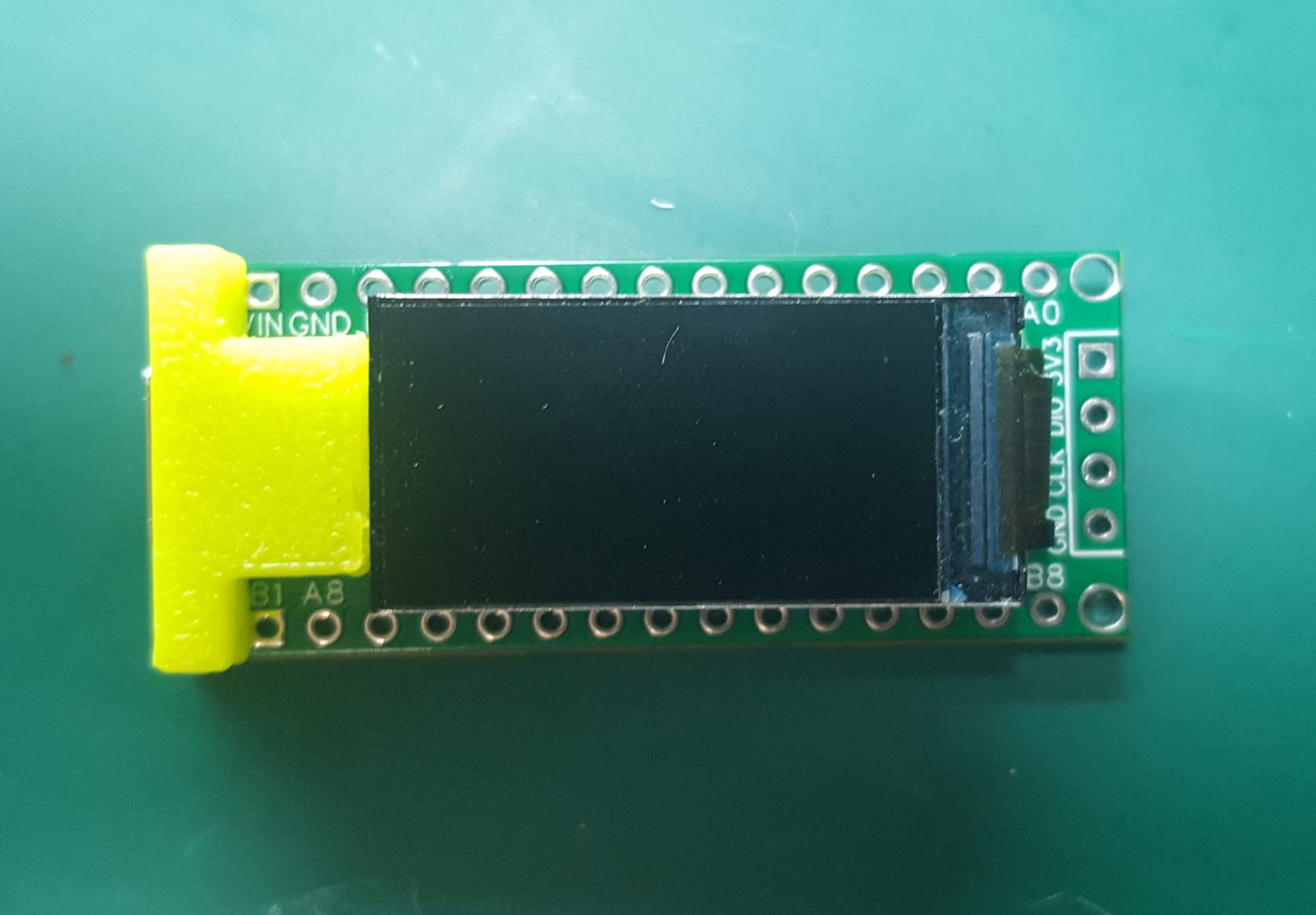

STM32G031G8 development board
The size and pin functions are exactly the same as Arduino Nano.
LDO selection comparison (more than just comparison) hell, I'm very sorry.
About automatic download
The stm32flash parameters  of the circuit referring to the punctual atom -i rts,-dtr,dtr
do not support CubeProgrammer automatic connection (because the control method is different).
PlatformIO needs to manually replace stm32flash with a new version to support the G0 series.
You must first manually use CubeProgrammer to connect the SWD configuration nBOOT_SELbit.
At present, it seems that it cannot be automatically reset after downloading, and there is still room for improvement.
About the screen
Use a 0.9inch IPS screen to drive ST7735S, 160x80
Please refer to Weixue wiki

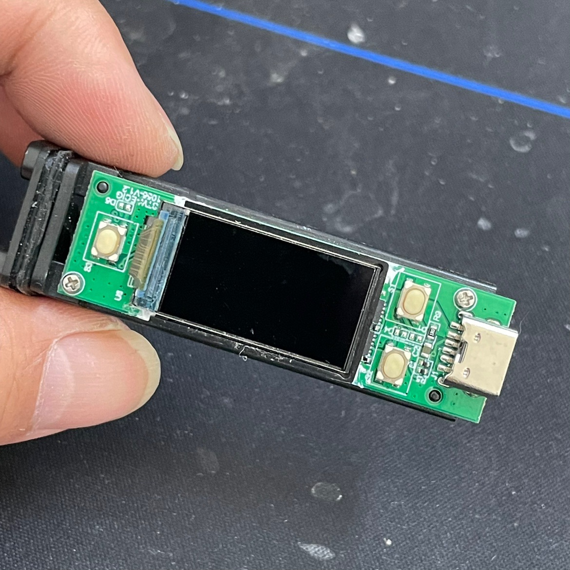

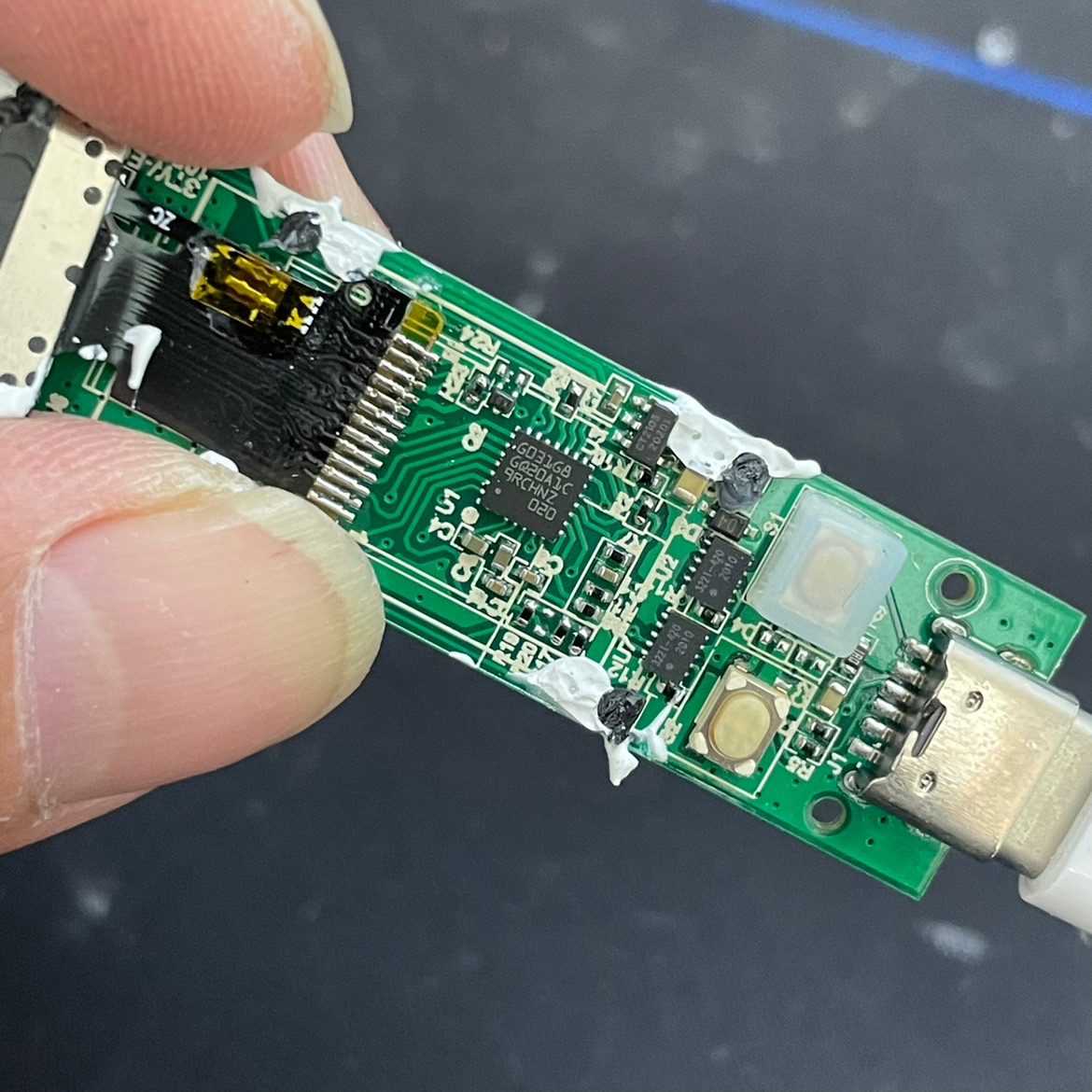

Why draw this board? Because I bought some electronic waste from Lao Wang’s family (pictured)
