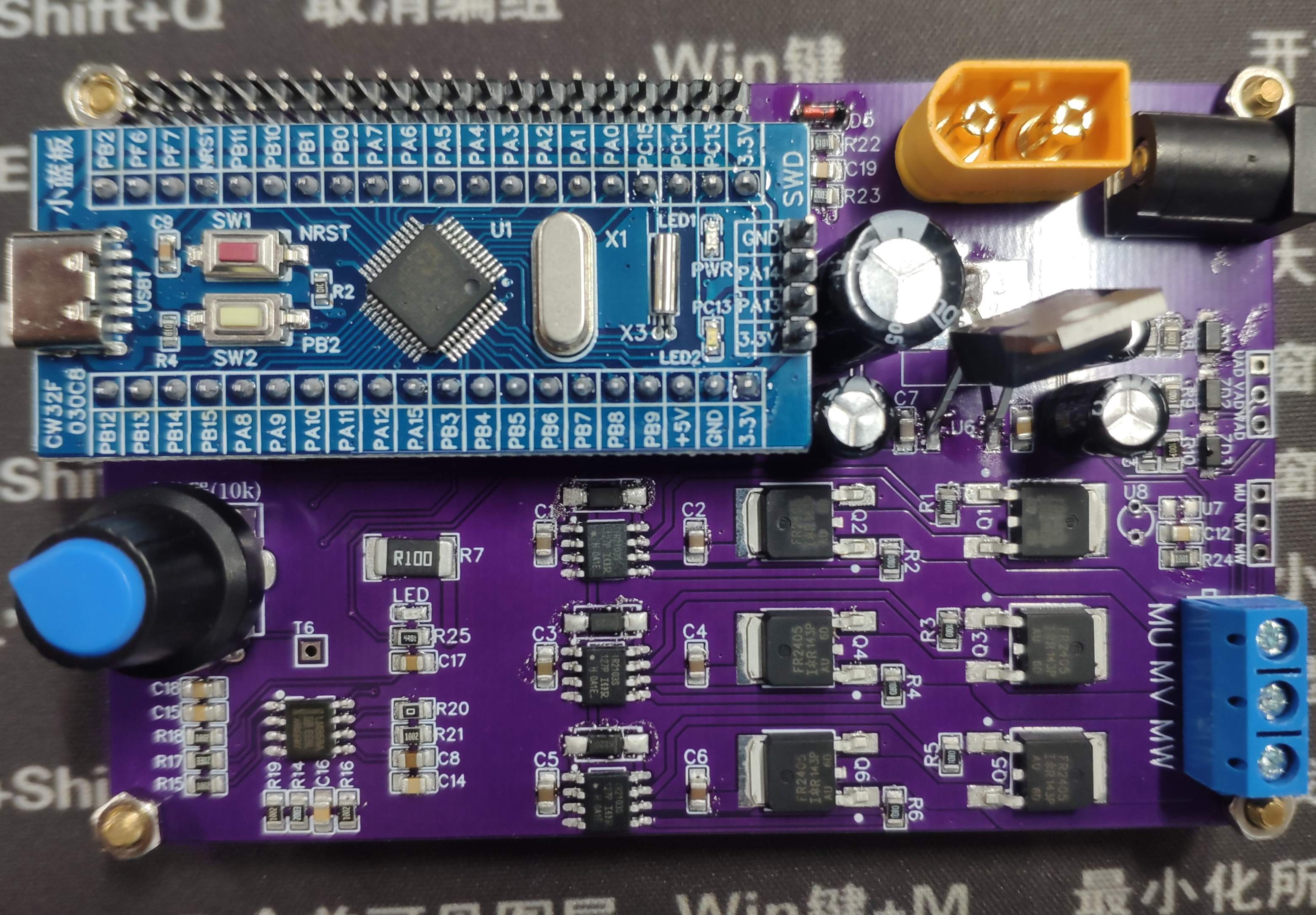

【CW32】Inductionless brushless motor driver
Use the cw32f030c8t6 chip to make an inductive brushless motor driver. The circuit refers to the official tutorial. The XT60 interface is added to directly plug in the model aircraft battery for power supply. The MOS tube is replaced with IRFR2405 (55V 56A). The self-restoring fuse is removed. Currently, the sample program cannot detect it. The zero-point electromotive force motor cannot run, and the reason has not been found yet.
