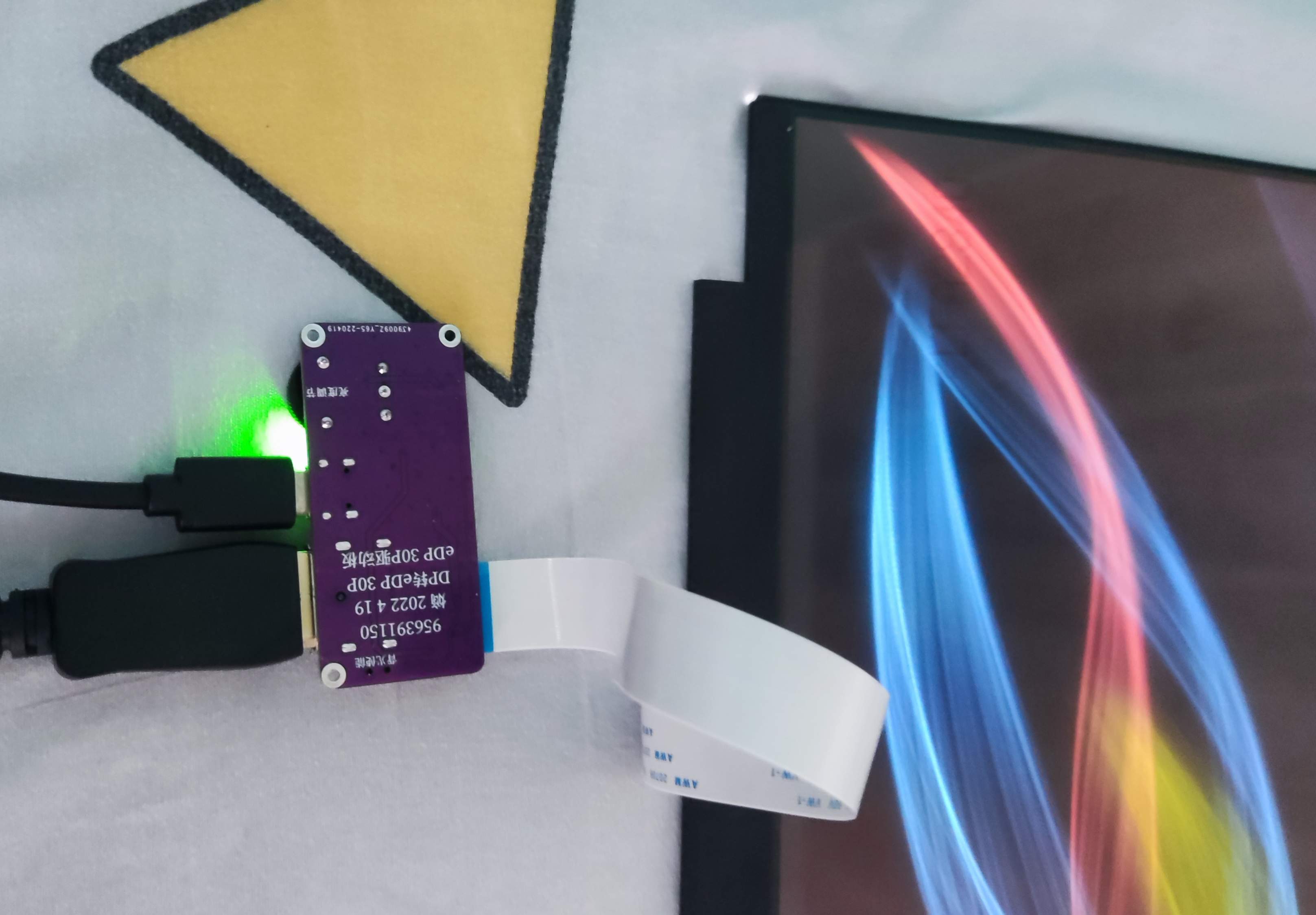

The screen and driver board have been successfully turned on using AMD and Intel core graphics.
Pay attention to the connection direction of the screen cable and the driver board (reverse connection may cause burns)
The screen cable I use: 0.5mm/30P EDP screen cable I-PEX 20453 FFC soft cable 3 yuan
The screen I use: NV156FHM-N48 15.6-inch IPS panel 1080P notebook A-screen 148 yuan
Theoretically, it can drive the standard eDP-30 pin specification display. For related information, please visit Panelook.
The whole screen power consumption reference data sheet is generally about 5W. USB TYPE-C power supply is just right.
Remember to turn on the backlight switch for the brightness adjustment function to be effective
The component BOM parameters are subject to the schematic parameters.
