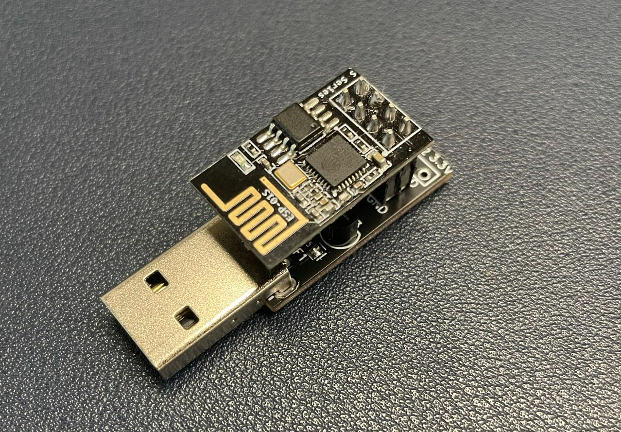

Cheap temperature measurement solution and computer room monitoring solution. Directly flash the ESPHOME firmware and send temperature alarms through Homeassist.
(This is my first post, any advice is welcome, thank you guys!)
1. Install HASSOS on a virtual machine
Reference: https://www.home-assistant.io/installation/windows
2. Install ESPHOME on HASSOS
3. Add a new sensor in ESPHOME
esphome:
platform: ESP8266
board: esp01_1m
wifi:
networks:
- ssid: "SSID1"
password: "PWD123456"
- ssid: "SSID2"
password: "PWD654321"
power_save_mode: HIGH
# Enable fallback hotspot (captive portal) in case wifi connection fails
ap:
ssid: "wendu Fallback Hotspot"
password: "1234567890"
captive_portal:
#Enable logging
logger:
# Enable Home Assistant API
api:
ota:
#Example configuration entry
dallas:
- pin: 2
#Individual sensors
sensor:
- platform: dallas
address: 0x1F0621933EC55928
name: "WENDU TEMPERATURE"
Burning software: ESPHOME FLASHER
https://github.com/esphome/esphome-flasher/releases
4. Edit and automatically send corporate WeChat alerts
