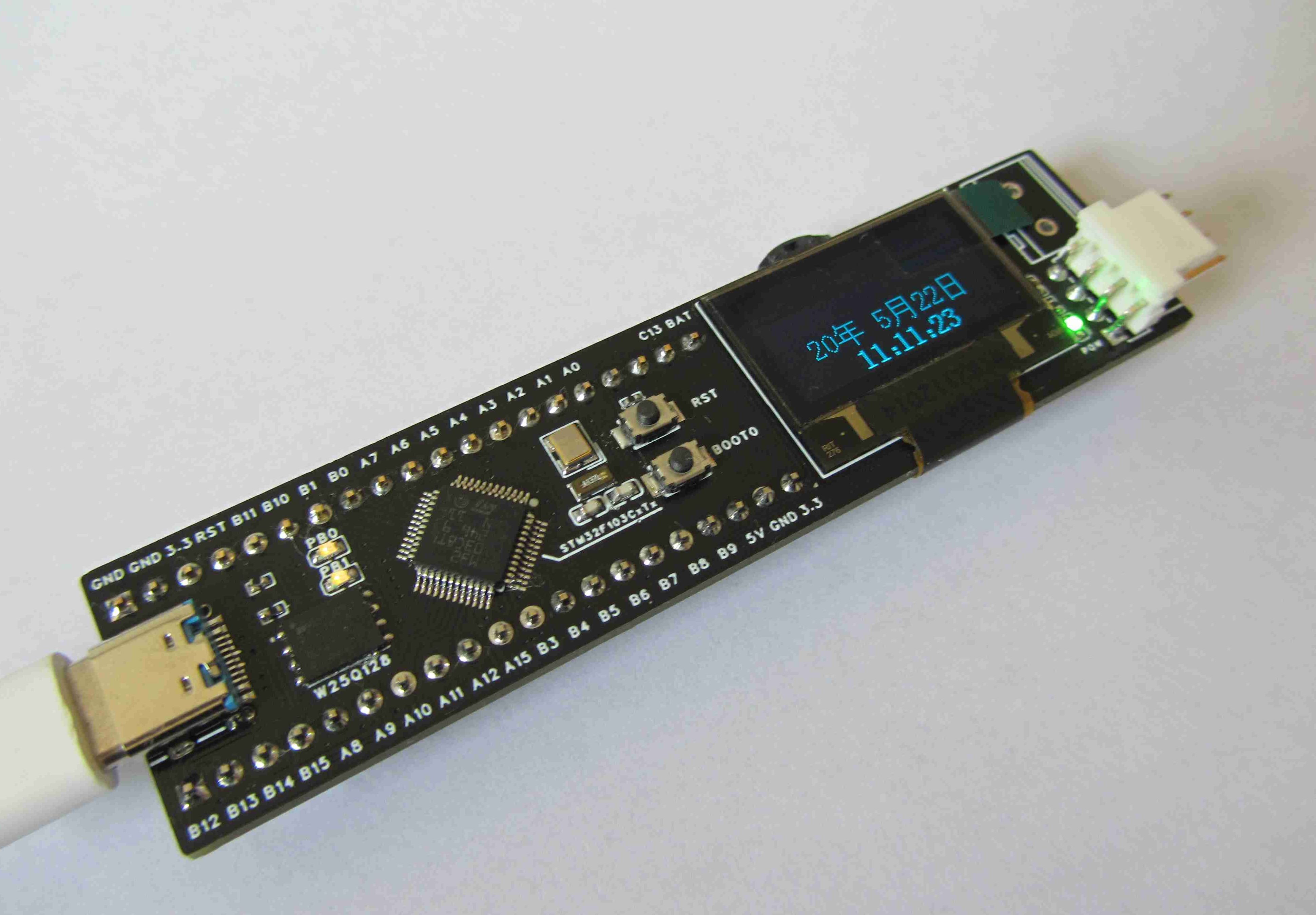

The pin sequence is compatible with common 40P core boards on the market. The relevant test code is written by STM32Cubeide . Please see the attachment for details.
Progress: 2022.05.04 V1.0 starts board verification
2022.05.18 V1.1 has been board tested and the C8T6 works normally
2022.05.26 V1.1 Modify the OLED time display code, add port configuration pictures, CAN to be tested
2022.07.25 V1.2 Modifies the 0402 resistor and capacitor package and replaces all with 0603 to facilitate welding. Friends who have verified are welcome to leave a message in the comment area
In the process of learning STM32, I came into contact with many high-quality tutorials. The traditional minimal system board on hand could not meet the needs due to too few pins, so I created this project based on the STM32CubeIDE+HAL library.
The PCB integrates automatic download, BOOT manual selection, large-capacity W25Q128 memory, 0.96OLED display, CAN bus, 3-way buttons, buzzer, backup battery and other basic peripherals.
Note: You may need to manually reset after programming using the serial port and SWD. The operation method is: press the BOOT0 and RST buttons at the same time.

1. Front view-TOP
2.TYPEC programming serial port and power supply
3. Bottom view-BOTTOM
4.OLED power-on display-TEST
5.OLED clock display-RTC
