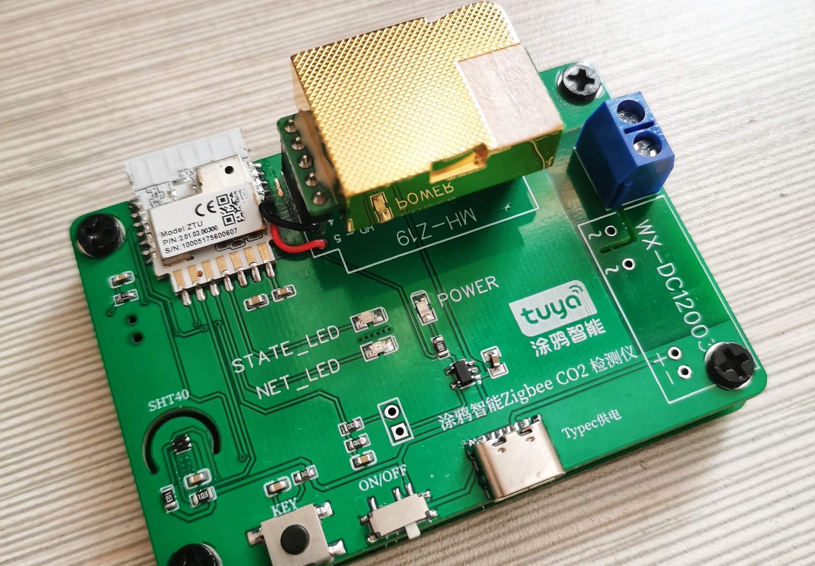

1. This project uses the CO2 alarm made by Tuya Zigbee (ZTU) module, which can not only detect the current air CO2 content, but also detect the temperature and humidity to form a linkage. It still requires no development and no need to write code;
2. This temperature and humidity meter has high-precision temperature and humidity detection functions, CO2 setting range and linkage alarm functions, and the trigger concentration is variable;
3. This module consumes low power and can be powered by battery through the reserved connection port or by installing a 220VAC DC module;
4. Built-in a high-precision SHT40 sensor, which can realize the function of temperature and humidity sensor, three uses in one machine.
1. This project uses serial communication between the MH-Z19C carbon dioxide sensor and the Tuya module (ZTU), which can detect the concentration of 400~5000PPM and has a service life of >5 years;
2.MH-Z19C carbon dioxide gas sensor is a general intelligent small sensor. The non-dispersive infrared (NDIR) principle is used to detect CO2 existing in the air. It has good selectivity, no oxygen dependence, long life, and has serial port output and PWM. This project only uses the serial port output.

PCB display:
