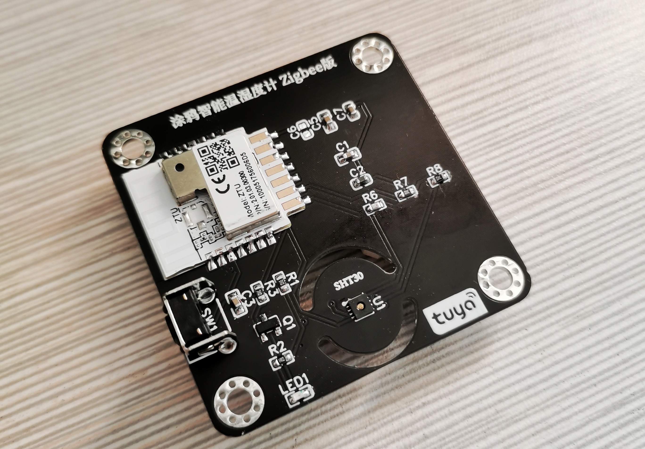

1. This project uses the gateway made by Tuya Zigbee (ZTU) module. No need to develop or write code;
2. This thermohygrometer has functions such as temperature and humidity display and range alarm;
3. This module has low power consumption and the actual usage time is more than 5 months according to the configuration.
The project has been going on since August to now, in order to test the power consumption.

Q1: PCB Note:
SHT30 is easy to solder, please make sure it is soldered correctly;
Q2: How to configure the network?
After the device is powered on, you need to press and hold the network distribution button to enter the network distribution mode. During the network distribution process, the network distribution indicator light will flash quickly, indicating that it is currently in the network distribution state. At this time, you only need to turn on the automatic search in the Tuya Smart APP to find that the device has completed network configuration (note: some mobile phones need to enable positioning and other permissions ). Other modules are determined according to the options you configure the module firmware at that time.
