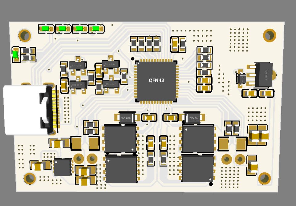

IP2368 supports 2/3/4/5/6 cells in series. The number of cells in series can be selected through an external resistor.
IP2368 supports an external resistor to select ordinary lithium batteries or lithium iron phosphate batteries. The external resistor can set the full voltage and lithium battery full voltage. Can be set to: 4.15V/4.2V/4.3V/4.35V/4.4V. The full voltage of lithium iron phosphate battery can be set to: 3.5V/3.55V/3.6V/3.65V/3.7V.
Integrated FCP input and output fast charging protocol
integrated AFC input and output fast charging protocol
integrated SCP input and output fast charging protocol
integrated DRP Try.SRC protocol, PD3.0 input and output fast charging protocol
integrated QC2.0/QC3.0/QC3.0+ output Fast charging protocol
