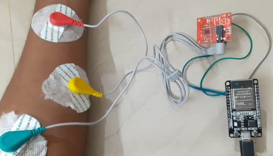

Alex Newton's tutorial demonstrates how to monitor the same ECG online on any IoT cloud platform. First, the AD8232 ECG sensor needs to be connected to the ESP32. The ECG leads are then connected to the patient's chest or hand to generate an ECG signal. Finally, use Ubidots parameters (such as API key or token) to send the ECG to the cloud through MQTT Broker.

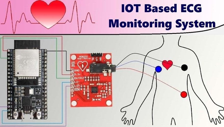

The circuit diagram connects the AD8232 ECG sensor to the ESP32-WROOM-32. The power supply voltage of the module is 3.3 V. Then connect GND to GND. The output pin of AD8232 is an analog signal, connect it to the VP pin of ESP32-WROOM-32. Likewise, the LO+ and LO- pins on the AD8232 should be connected to the D2 and D3 pins on the ESP32-WROOM-32 respectively.
