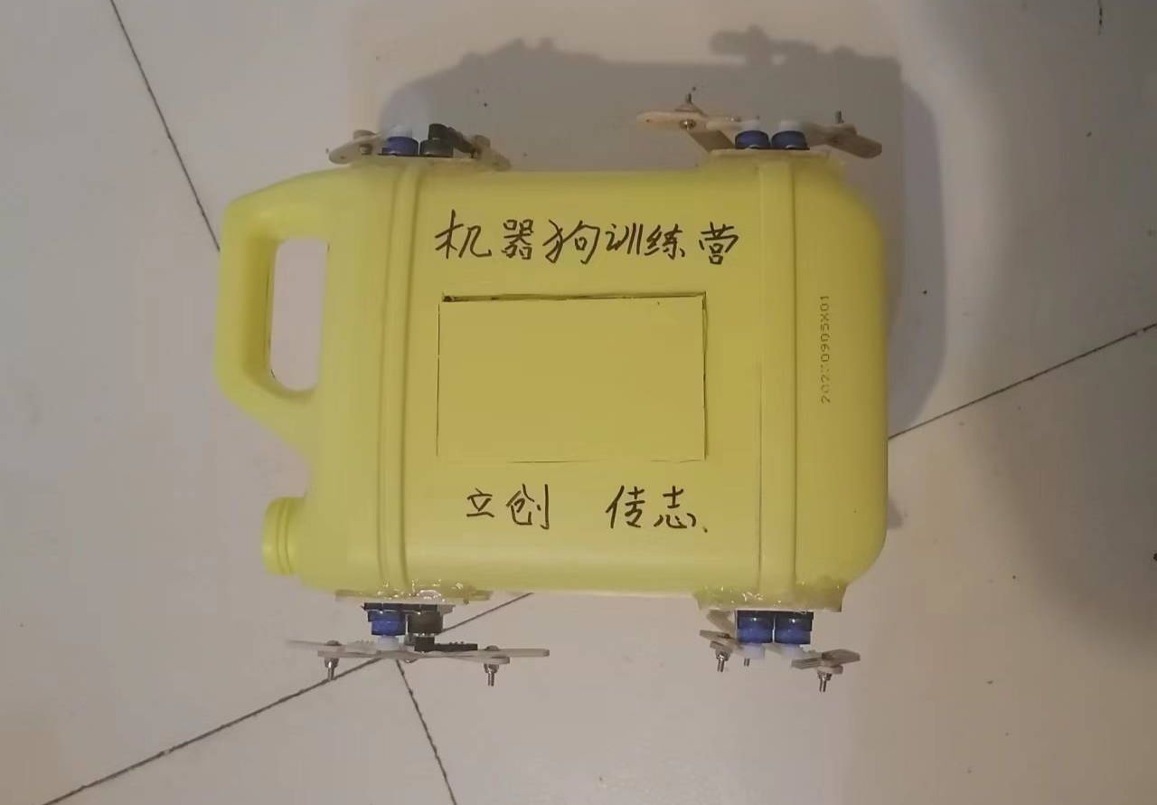

【Training Camp】Bionic Robot Dog--A Walking Cleaning Dog
Product introduction: Developed based on the OpenHarmony open source Hongmeng system. The chip used is hi3861, which supports 16-channel servo control, GPIO, ADC, PWM and other operations.
Application scenarios: Can control robot dogs, small spiders, servos, gimbals, robotic arms and other products, supporting up to 16 channels of servos
Chip solution: multi-channel steering gear control board based on HiSilicon Hi3861 chip and PCA9685
Officially provided documentation, firmware and related information:
Extraction code: qu2s
Production process teaching: Follow the official EDA account on Station B. In addition to the teaching videos of this event, you can also see the teaching videos of previous events.
            The teaching video link for this event: https://www.bilibili.com/video/BV1RU4y1D75p?spm_id_from=333.999.0.0
Official project case link:
Chuanzhi Education website used when installing the servo (you must first connect to the WiFi of the HI3861 chip to perform this step): 192.168.10.1
Working voltage: 7.4V~ 12V
Hardware interface: All are cheap DuPont wires.
Double-layer board design single-sided layout
Total material cost of the complete set: 145 yuan
pcb: Jialichuang free prototyping
Components: about 50 yuan,
8 servos (5.7 yuan each for a certain treasure) + PCA9685 (more than 10 yuan for a certain treasure): 65 yuan
Dog body structure: dish soap bottle (0 yuan)
                    15 ice cream sticks (ice cream sticks that the children have finished eating. Just collect them casually) (0 yuan)
Others: Some M2.5 screws, anti-slip nuts and self-tapping screws, about 10 yuan. Two 18650 lithium batteries: 9 yuan. 18650 battery box 1 yuan 1
Minus Lichuang 80 volumes.
Thank you for the training camp organized by Lichuang Chuanzhi. Even if you don’t have a ticket, you still have to participate.
