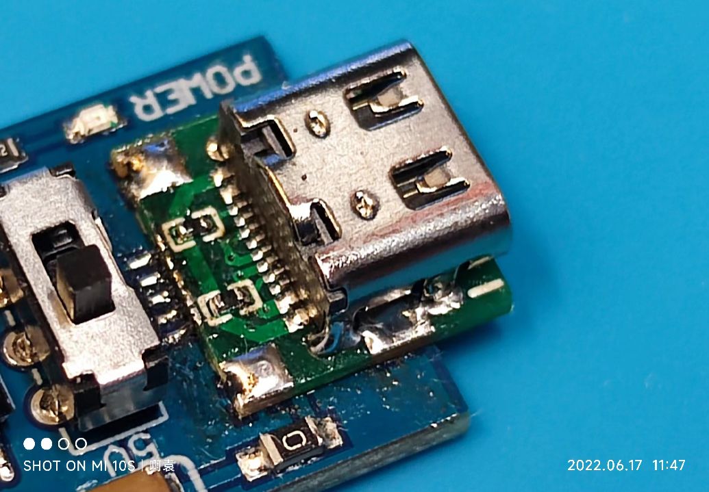

When using it, first remove the old MiNiUSB interface that needs to be transferred, cut the adapter plate flatly along the white line on the left side (you can also not cut it, it will be more difficult to solder), and solder the adapter plate on it like a patch. On the pad of the old interface, solder the USB_Type-C_16P socket and it will be OK. If there is no power supply when using the CC line connection, just add two 5.1K pull-down resistors.
Before welding the adapter board:
Remove the old seat and weld the adapter plate:
Welding Type-C seat:
Test (CC line, connected to computer):
Test (CC line, connected to mobile phone):
