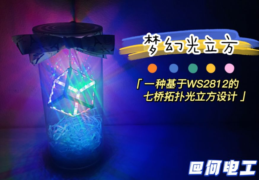

  • Overall design:
A frame-type light cube built using 36 WS2812 lamps. The color of each lamp bead can be independently programmed and controlled.
The luminous lamp is divided into two parts: the light cube and the controller, which are connected using a three-core power cord.
As a fan of CC cables, I must use Type-C for power supply. I currently have no plans to install a battery. After all, I designed it as a night light.
  • hardware design:
The light cube part is composed of 12 independent small plates. Each small plate is one side of the cube. It is installed at an angle of 45° to ensure that it can be seen from all angles.
