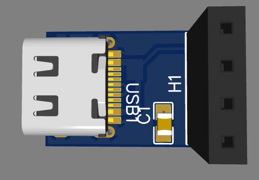

There are a lot of tools for converting USB to TTL in Aubao, but they are all moricUsb, but after looking at the desktop, they all have TYPE-C cables. I have a headache, and I still have to find the cables. I decided to make a TYPE-C tool and took a look. The price of CH340K is acceptable. Lichuang's dad only sold it for more than three yuan. I bought it and developed this tool. This tool directly uses USB power supply and adds a ground capacitor on pin 10 without adding any DCDC or LDO conversion voltage. It can work directly.
