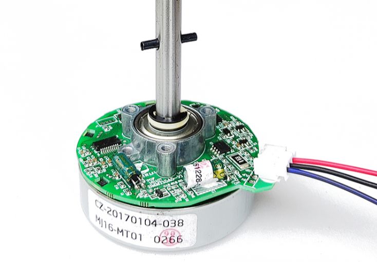

In order to get the fan blade seat, I purchased a breeze electric fan from this company (I used an old fan that I had on hand, other companies may not be able to install it this way. If you have an old fan, you can try it): https://detail. tmall.com/item.htm?id=641443686991&spm=a1z09.2.0.0.53f32e8doNGE1I&_u=r284nul44bb
01--This is a 12.3 yuan motor.

4--Short the wires according to this picture, and the fan will reverse
5--Click to get this fan casing, you can only dismantle the old fan
6--Just for the seat to install the fan blade, cut it as shown in the picture.
7--Remove the unnecessary magnet again
8--Finally got the external fan blade seat
9--Press the hammer on the motor again and hammer it down. Rest assured that the size is just right.
10--Install the PCB and motor, that’s it, OK
11--Put a big nut on the screw to install it properly
