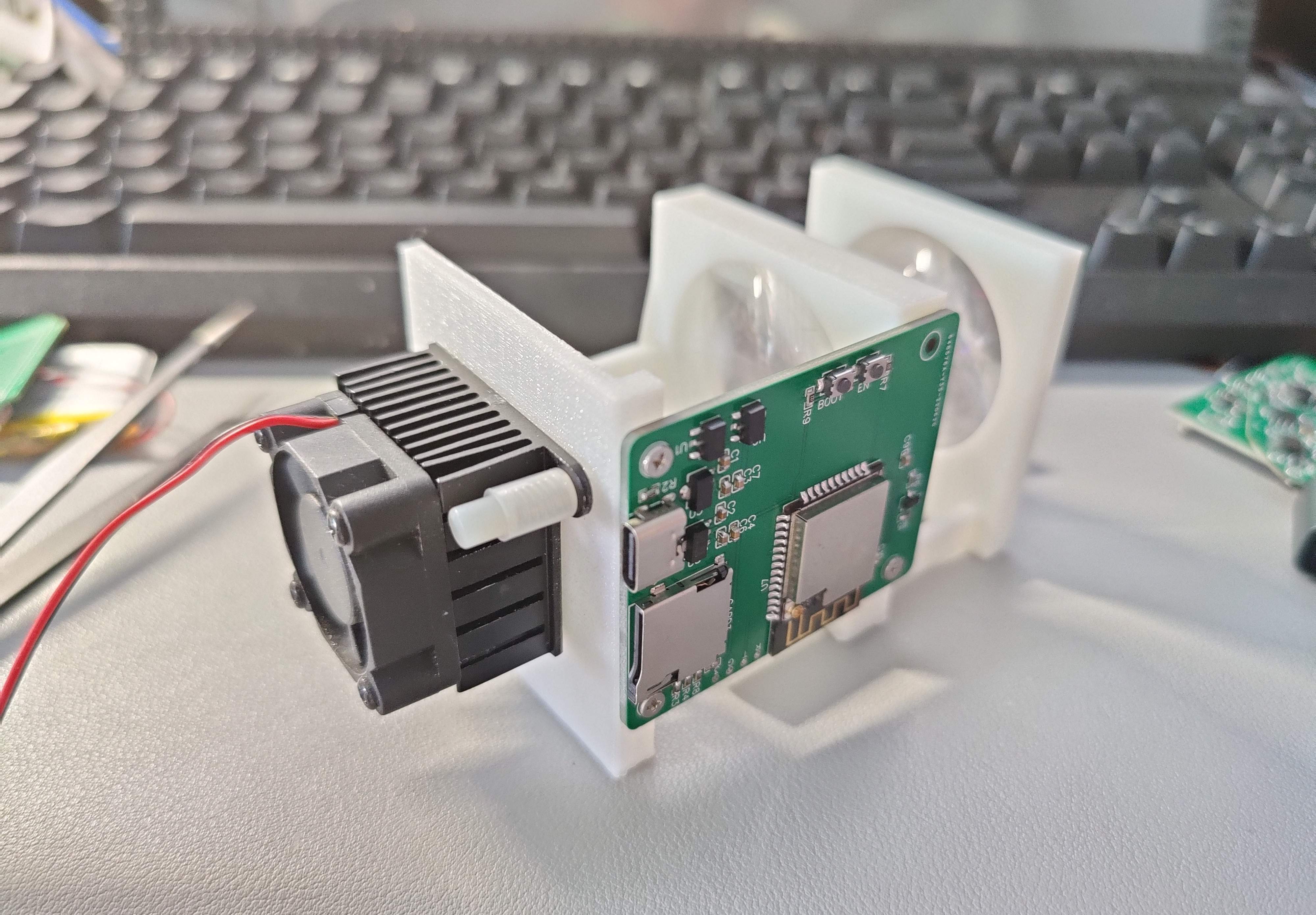

Introduction:
The video playback firmware uses the Arduino_GFX library (version 1.1.1) to drive the screen https://github.com/moononournation/Arduino_GFX
The video playback code comes from https://github.com/moononournation/RGB565_video
The clock firmware is based on a modified version of the SD² desktop clock (original address: https://oshwhub.com/MisakaBanBan/small_desktop_display )
IDE using ArduinoIDE: arduino.cc
ESP32 library version: 1.0.6
The main control uses the ESP32-WROOM-32D module
The screen uses an ST7789 LCD screen, and then the backlight is removed, leaving only the liquid crystal layer and polarizing film layer.
The buck IC uses two AMS1117-3.3, one supplies power to the main control and screen, and one supplies power to the LED light.
The LED cross-flow IC uses two AMC7135s in parallel. One outputs 350mah current, and two in parallel are 700mah.
The 10W 5050 white light T6 lamp beads used for LED are only turned on to 2W. Any higher power will burn out the LCD screen.
The LED lens uses a 60-degree lens
The front and rear Fresnel lenses use two Fresnel lenses, one with a 40mm focal length and one with a 35mm focal length.
The effect of a distance of 50CM:
It may actually be a little darker than the photo
Known issues and fixes:
Since LDO is used to reduce the voltage (cheap), the LDO (number U3) responsible for the voltage reduction of the LED will be seriously heated (75℃+). If there is time later (cuckoo), it will be replaced by a DCDC circuit to reduce the voltage.
There is no sound when the video is played. If I have time later, I will add a power amplifier circuit and a small speaker.
The screen will be heated by the lamp beads. I only continued the test for 3 hours. The screen was normal except for the high temperature. It is not ruled out that the screen will be burned out after long-term use. If it is burned out, please reduce the input voltage of the LED.

Note: Only the optical components on the back of the screen need to be removed. Do not tear off anything on the front except the protective film, and do not tear off the polarizing film! ! !
Normal screen:
Remove the backlight assembly:
Cut off the backlight power supply:
After cutting:
Assembly:
PCB and frame are connected using M2*4 screws
Apply silicone grease as much as possible between the T6 lamp bead copper substrate and the heat sink.
detail:
