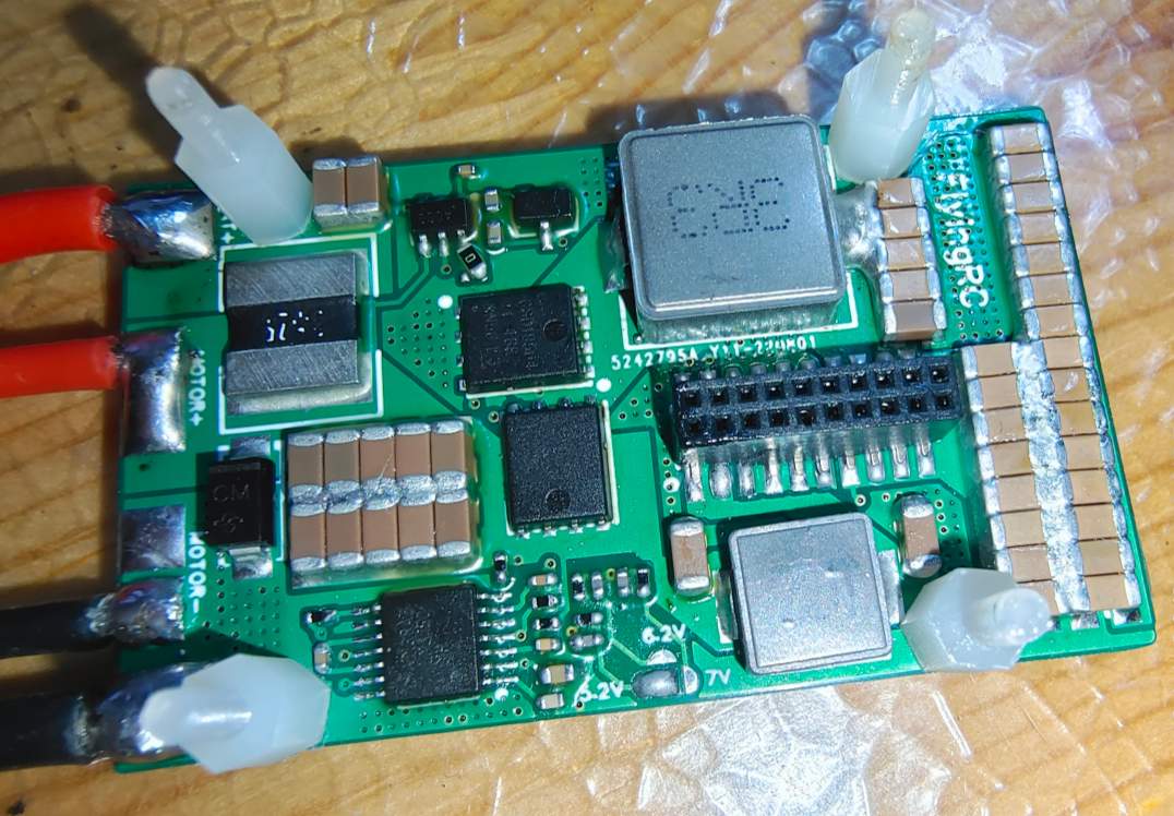

Bottom BEC and distribution board FOR FlyingRC F4Wing MK2
components purchase
Both resistors and capacitors can be purchased at TB Youxin Electronics. The packages are mostly 0402. Pay attention to the resistance and capacitance values in the BOM.
name | quantity | Link |
LM3150MH | 1 | https://item.taobao.com/item.htm?id=576605597683 |
CSD18504 | 2 | https://item.taobao.com/item.htm?id=612966488725 |
ME6206A33XG | 1 | https://item.taobao.com/item.htm?id=572932814723 |
MAX44284HAUT+T | 1 | https://item.taobao.com/item.htm?id=674882807888 |
0.25mR alloy sampling resistor | 1 | https://detail.tmall.com/item.htm?id=607894738107 |
SMAJ33A | 1 | https://detail.tmall.com/item.htm?id=625099727586 , the ending is not CA |
3.3uH 1040 inductor | 1 | https://item.taobao.com/item.htm?id=10840816607 |
22uH 0630 inductor | 1 | https://item.taobao.com/item.htm?id=528379639825 |
