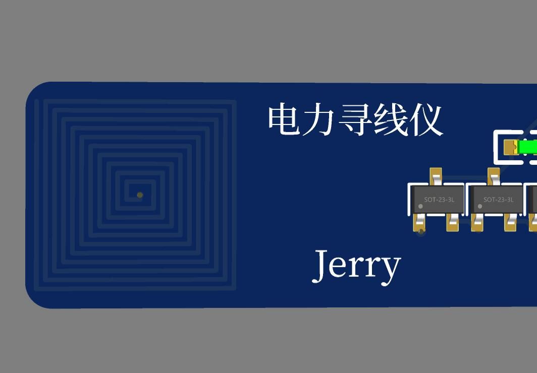

Weak power sensor uses three NPN tubes connected in series. When the red light turns on, it is detected.
You can also use a 9v battery, add a 220 ohm resistor and a buzzer between the light and the positive terminal, and it will sound.
