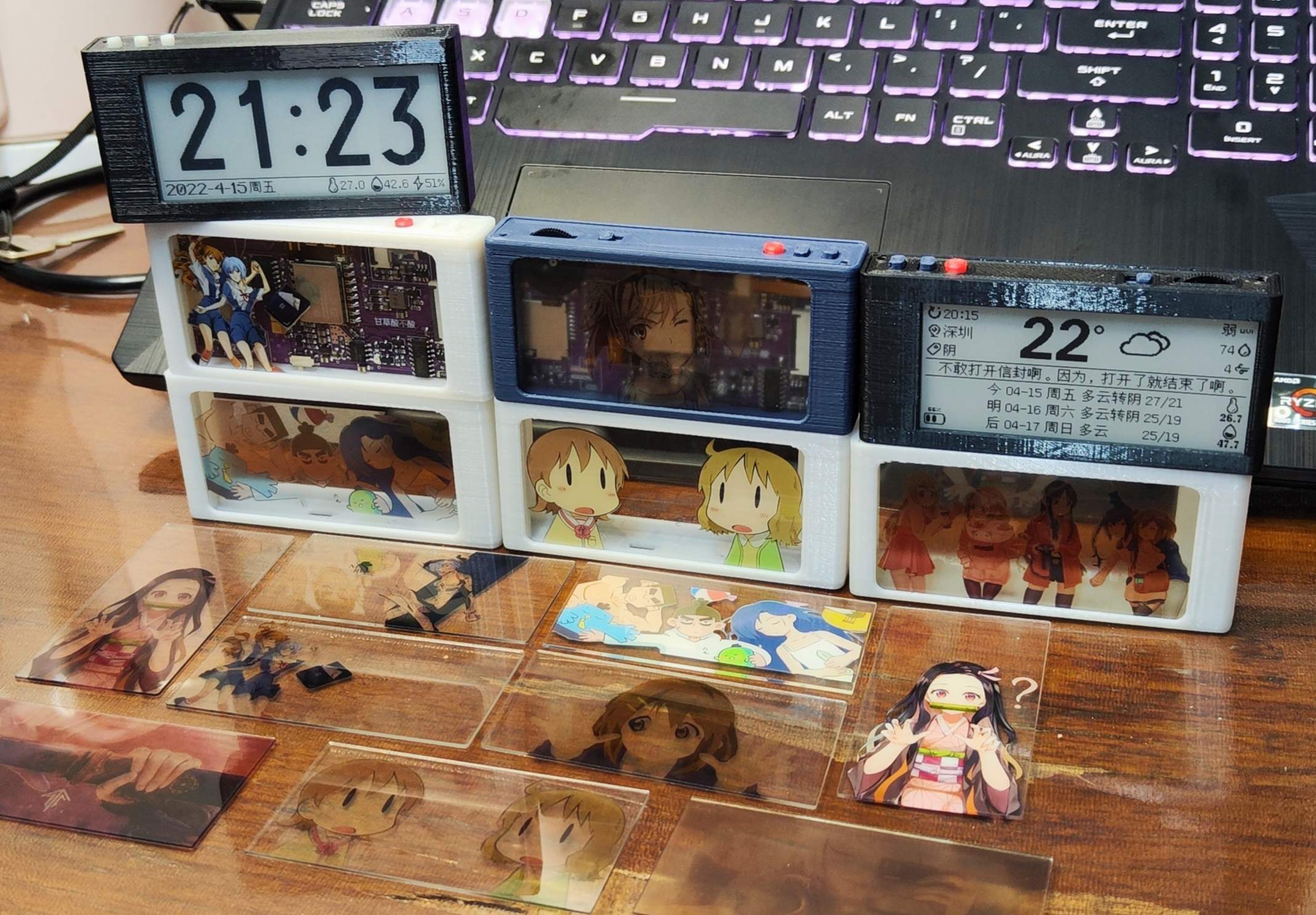

[Professional Edition] V2.43-2.9-inch SD ink screen reader
[Professional version import] V2.43 multi-function ink screen-SD card version
  • Imported from kicad to Lichuang EDA professional version, the conversion effect is much better than the standard version, and there is no problem in direct editing.
  • The front light ink screen with 4 lights connected in series has been discontinued. The front light circuit does not need to be soldered and corresponds to the left and right frames on the PCB.
  • The firmware is compatible with all versions of PCB, link https://gitee.com/Lichengjiez/weather-ink-screen/releases
  • I will upload the file later which can be used directly on Jiali Bandage patch.
  • The changes are not big, so it has not been board verified yet.
More function introduction
[New UI] 2.9-inch SD ink screen reader
Weather ink screen-add clock chip
Development history of front-lit ink screen
