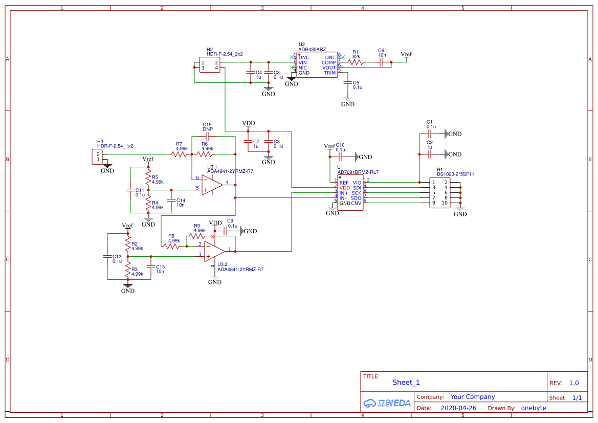

This design is an analog-to-digital conversion module verification board based on AD7691BRMZ-RL7. The AD7691 is an 18-bit, 1.5 LSB INL, 250 kSPS PulSAR differential ADC that is widely used in battery-powered equipment , data acquisition , seismic data acquisition systems , instrumentation , and medical instruments. This design will be used to verify the excellent performance in AC signal sampling.
