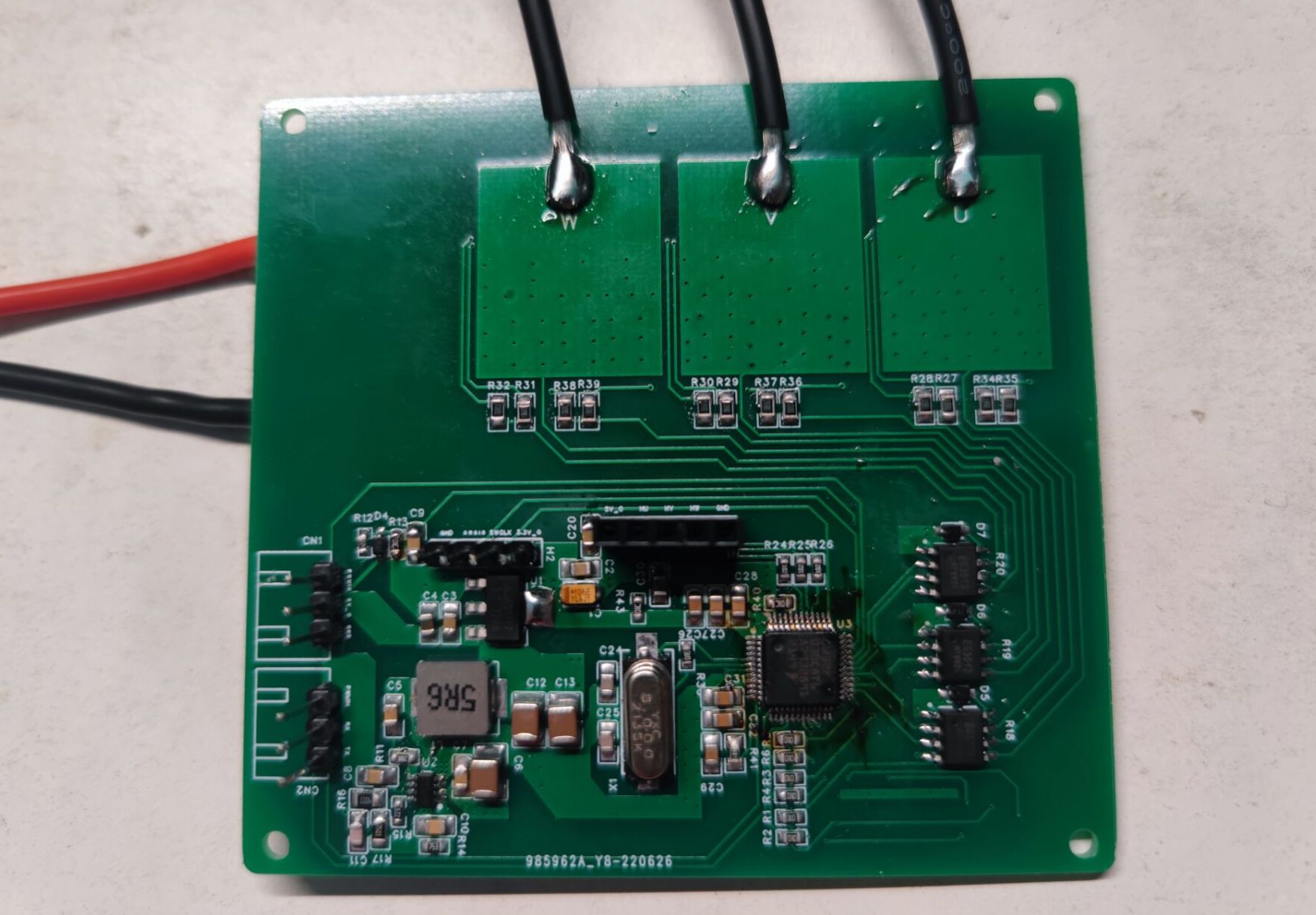

So the real thing is as follows:
                                                                                                                                                                                                                             Figure 5 Front view of the actual object
                                                                                                                                                                                                                         Figure 6 The reverse side of the op amp filter capacitor before modification
                                                                                                                                                                                                        Figure 7 The reverse side of the modified op amp filter capacitor and bootstrap capacitor packages.
    I put two negative sides here because I don’t want to dismantle the MOS anymore. The current circuit is a little imperfect, so I added a MOS and soldered it. I come from a poor family, and the dozens of MOS I bought have almost been blown up. I hope that the reviewer will not worry about this because I am bleeding so much. Thank you. However, I still have to say that the conditions at home are limited and I can only get a few amps of output current, so I have not tested whether this board can really withstand a large current of 30A. Each of the upper and lower tubes here uses two 80A MOS, which is also very convenient for laying heat sinks, so there is no need to worry too much about MOS. I am mainly worried about the copper coating below. Although it has a large area and a large number of vias, it has not been tested after all, so it is still a bit weak. However, there is also a solution, which is to open a window in the copper cladding and then solder the copper strips to increase the overcurrent capability of the internal circuit.
