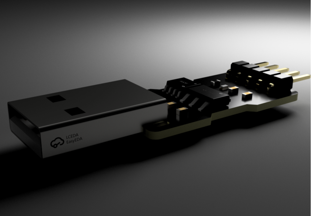

CH340N USB-TTL downloader
Release Notes
1. Update the plate shape to make it easier to hold
2.Change the routing
3. Add teardrops
chip
CH340N is a USB bus adapter chip that implements USB to serial port and supports 5V power supply voltage and 3.3V power supply voltage. Full-speed USB device interface, compatible with USB V2.0. Hardware full-duplex serial port, built-in transceiver buffer, supports communication baud rate of 50bps~2Mbps. Built-in clock, no external crystal oscillator required.
      Chip pin description
Instructions for use
      1. There is no anti-backflow treatment, and the unified power supply of CH340 and MCU is required.
      2. 3.3V and 5V have been led out, you can choose independently
Rendering
