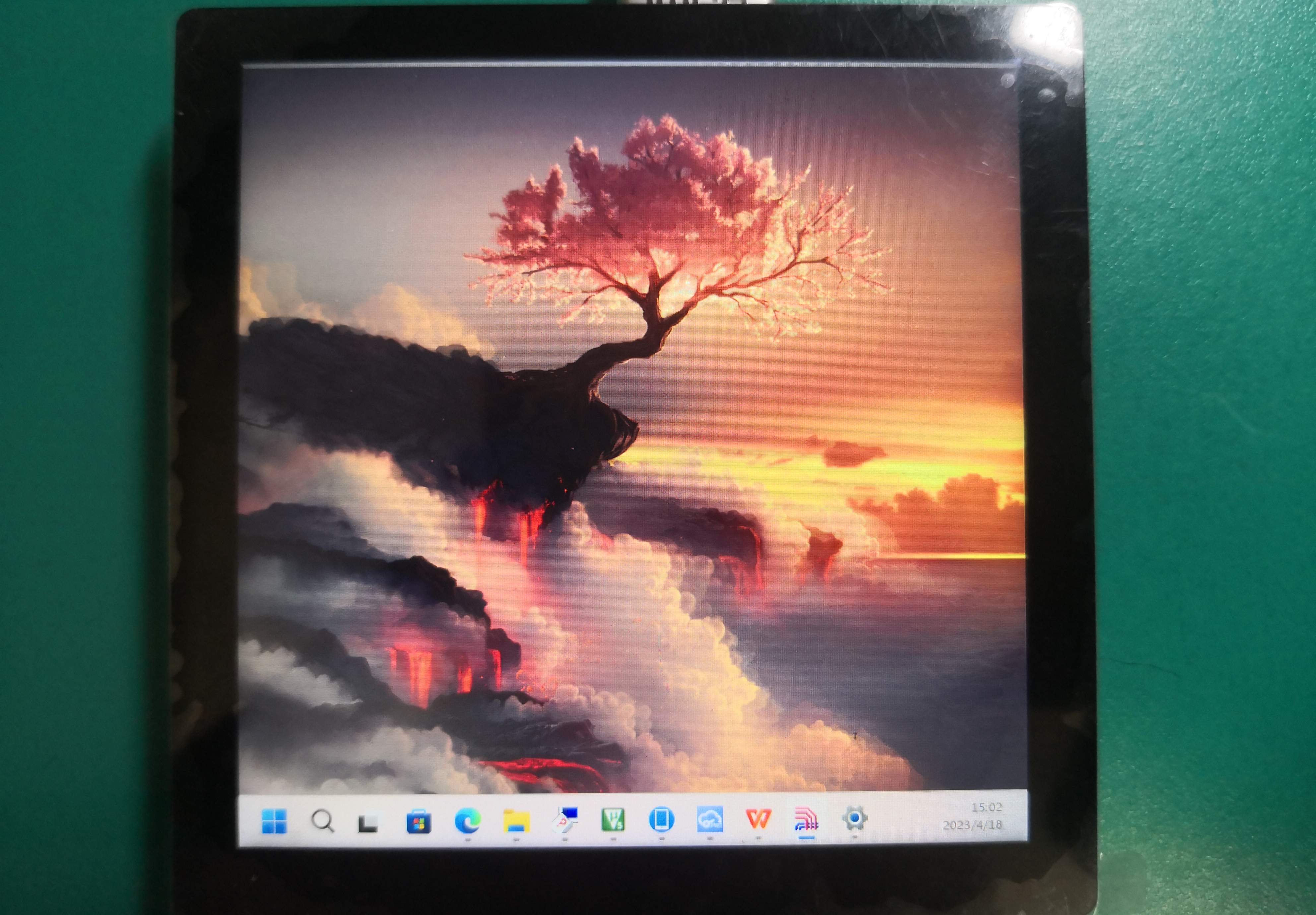

Actual picture:

Display effect:
Install a 70mm large dichroic prism, the effect please see the attached video demonstration (shell design):
